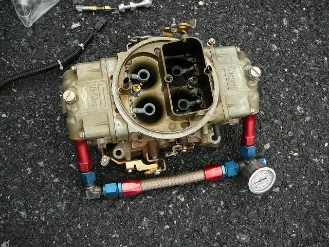

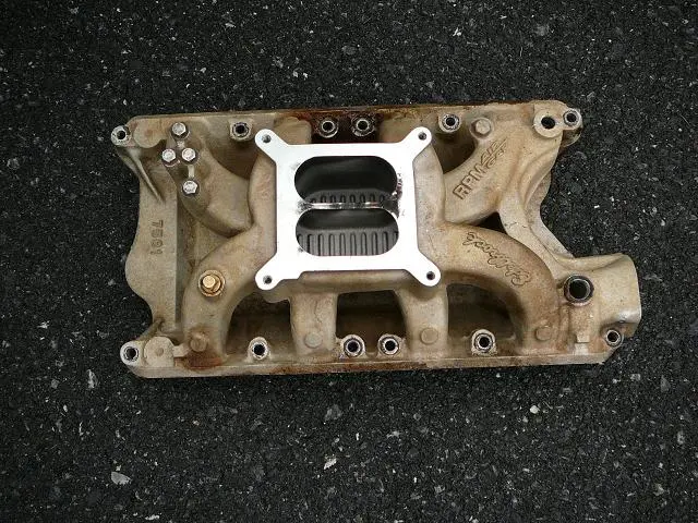

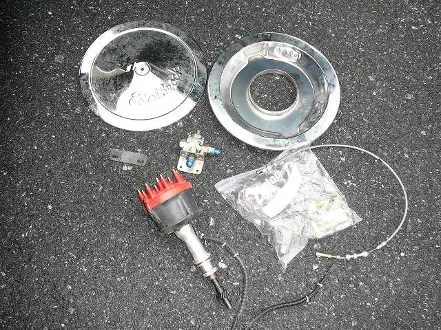

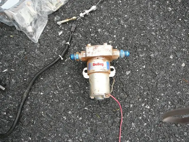

the intake ... RPM Air-Gap
the carb ... HLY-0-4779C
the dizzy, fp reg, air cleaner stuff, a cable, and other brackets and hardware
the fuel pump ... Holley Blue Pump
it's starting to take shape ...

what is this device
something new from sema?
