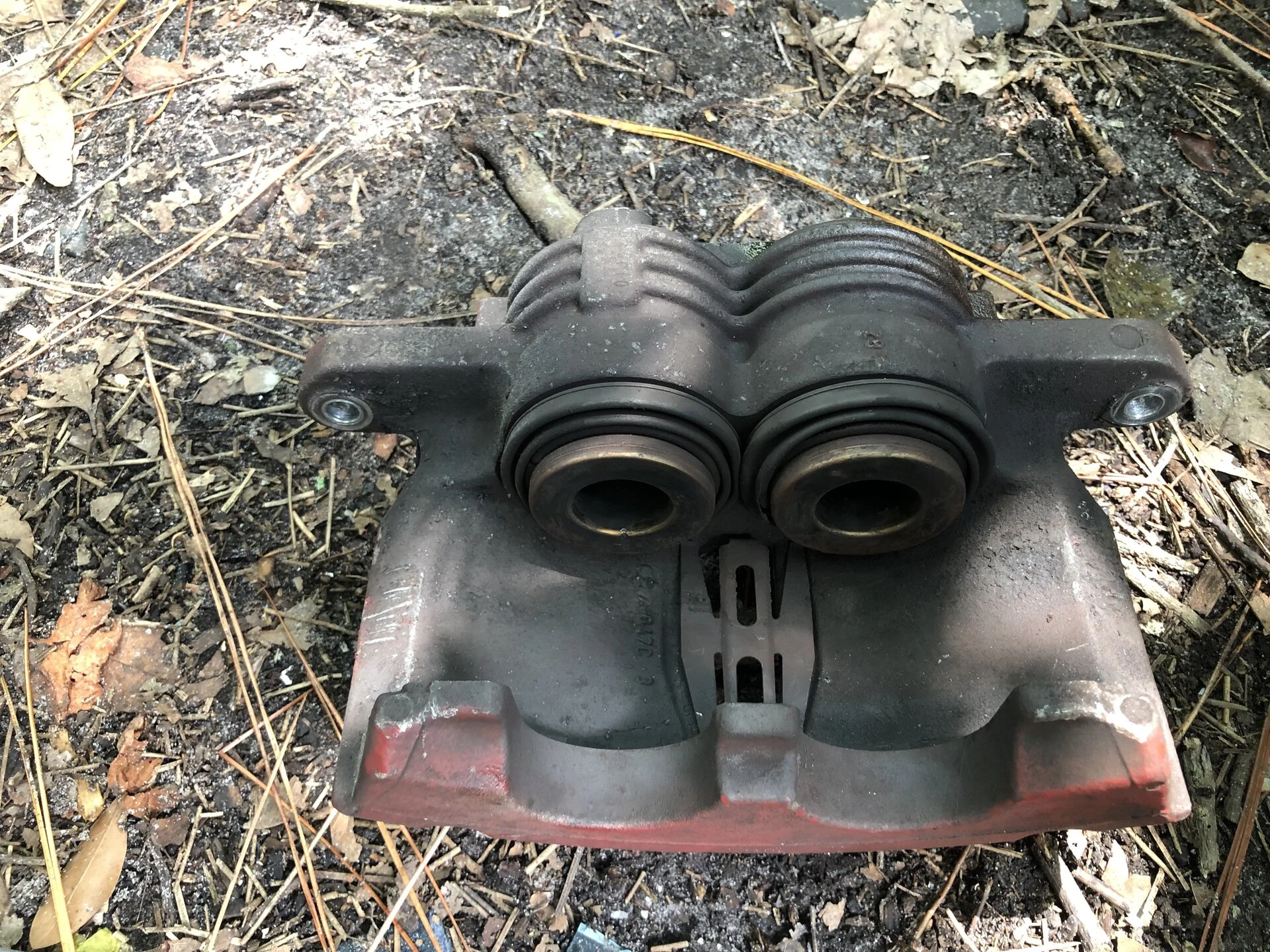

Yeah, This thing had the death grip on my rotor. I had to pry it off. To look at it from the outside you would never know it was frozen. I could not get the pistons to break lose with a C clamp or the giant pair of channel locks I use to push brake pistons in..
