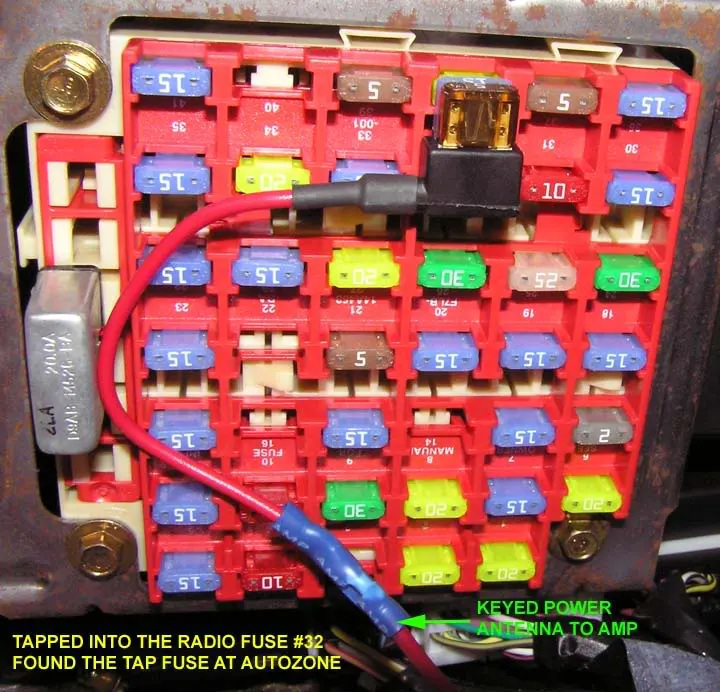

While checking the wires going to my headunit, the antenna wire touched the heatsink on the HU and a fuse seems to have blown out. The glove box light went out, the dome light went out,the headunit isn't getting power, and the BINGER noise thing doesn't happen when the key is in the ignition with the doors open, except for only when the seatbelt light is on..
I checked the fuses under the hood and they all seem to be OK, but I didn't have time to pull each one and check it for sure because I had about 3 minutes to get to work when this happened..?
Are there any fuses located anywhere else in the car and what fuse did I blow out?
Thanks
Under the dash on the drivers side, left of the steering wheel. :nice:
