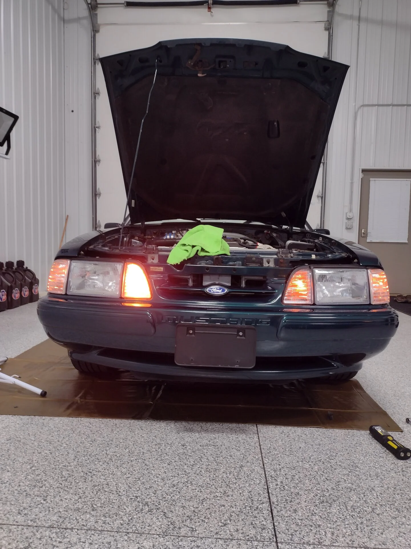

Well guys looking into it more. Left blinker works. It blinks on the dash and both front and rear lights blink.
The passenger side just stays green arrow on dash. And the rear passenger light does stay on but doesn't blink. Same with the front.
So maybe a relay or still the blinker/wiper lever?

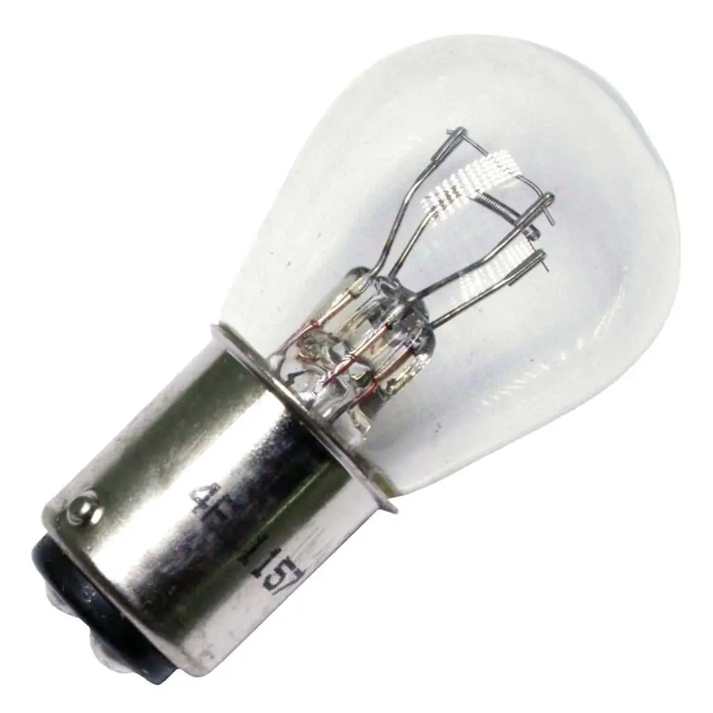

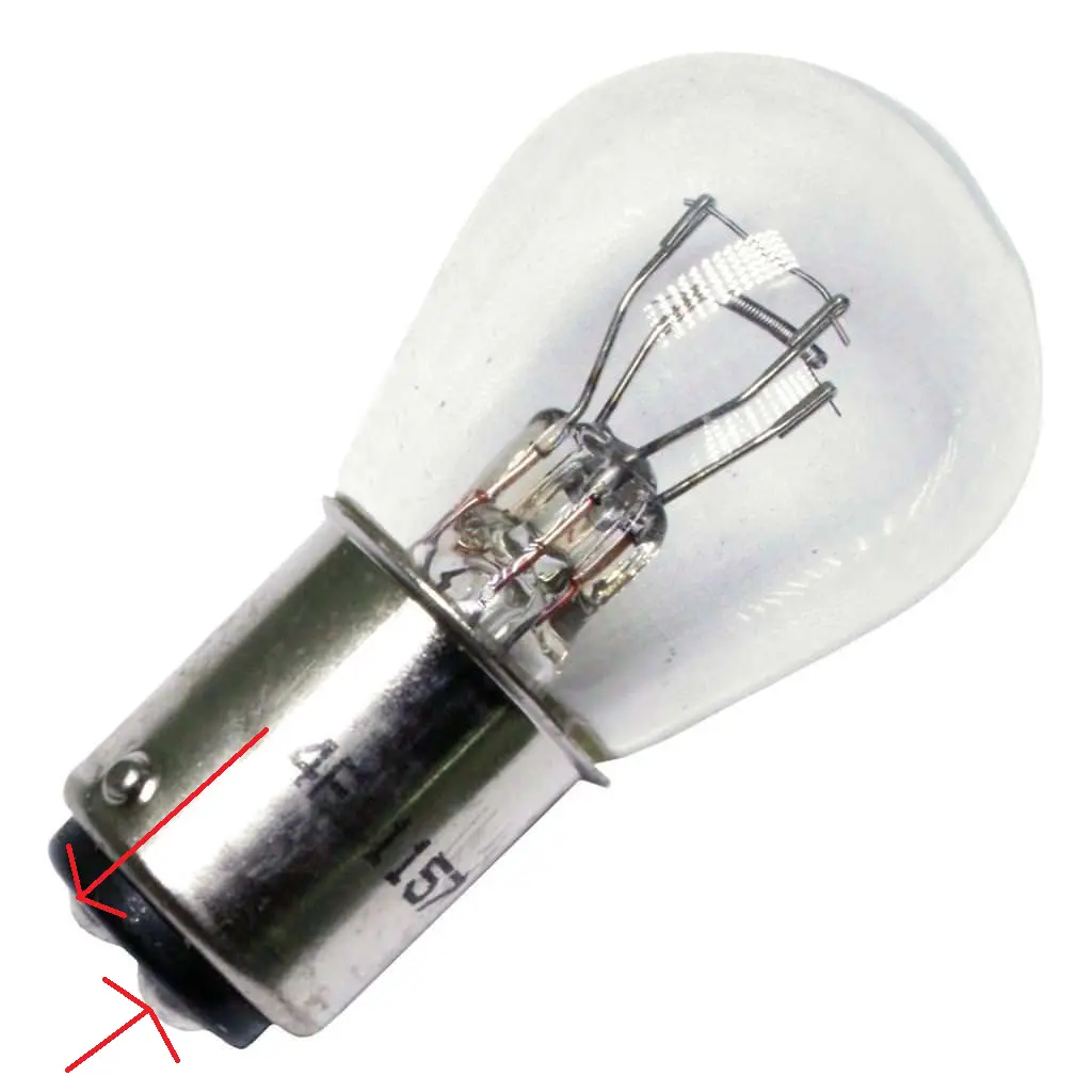

You can see in this image that lighting up isn't the end:
One bulb = Two lights
One of those filaments is for brakes and blinkers. The other is for running lights.
Gotcha thanks. It is weird because the passenger side blinker light is much brighter than the drivers side.
I'll start with looking at connections to the bulbs and replace them too.

Ignition "on". Both turn signal blink, hazards work. I need another person to verify, but my passenger head light brights not be working. Plus the extra bright blinker light posted above is weird.
