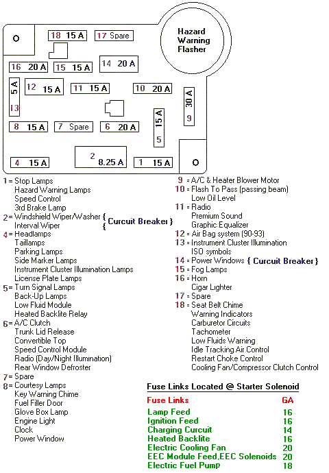

See the following website for some help from Tmoss (diagram designer) & Stang&2Birds (website host) for help on 88-95 wiring http://www.veryuseful.com/mustang/tech/engine/
Ignition switch wiring
Fuel pump, alternator, ignition & A/C wiring
Computer, actuator & sensor wiring
Fuse panel layout
Vacuum routing
