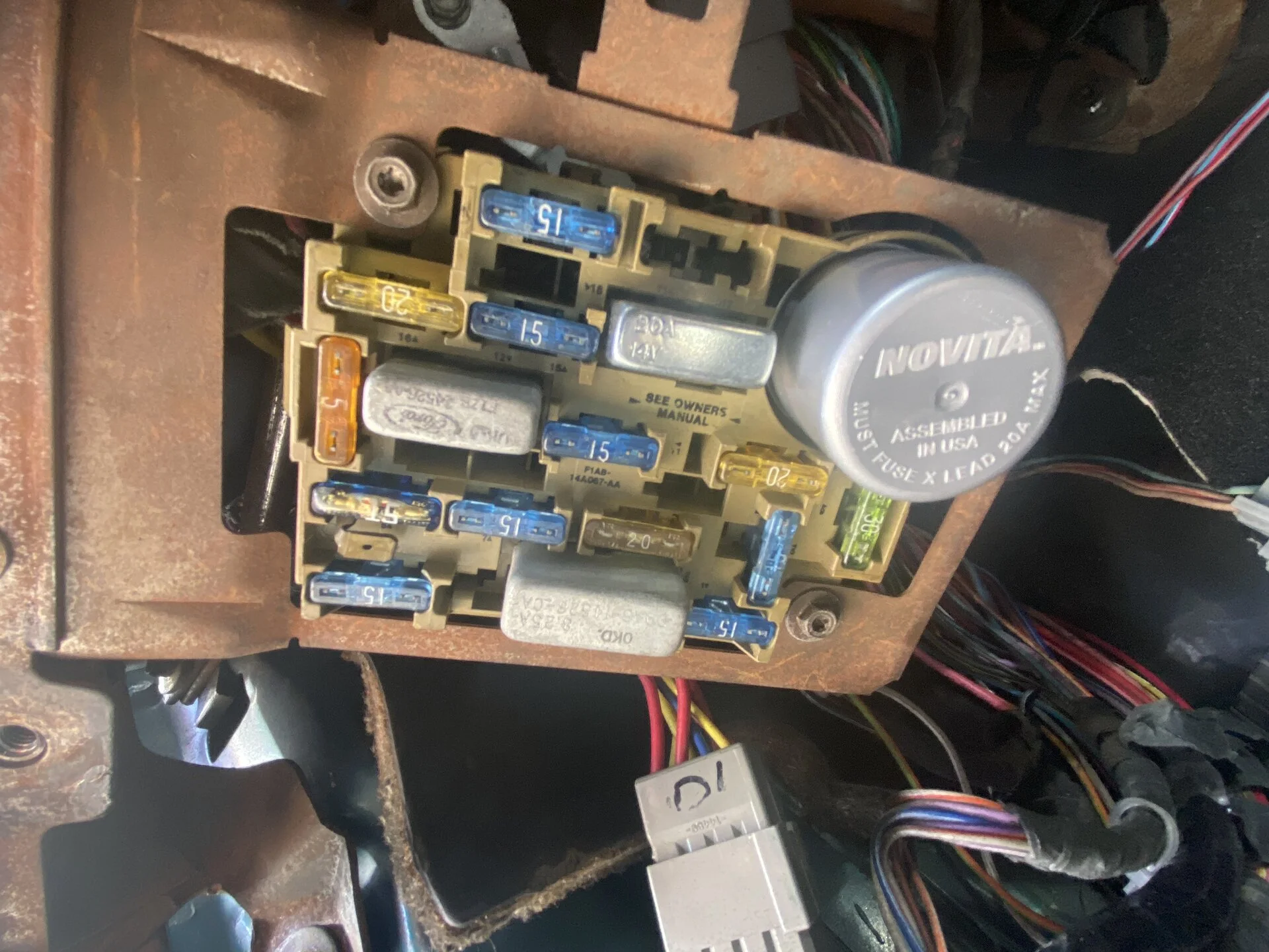

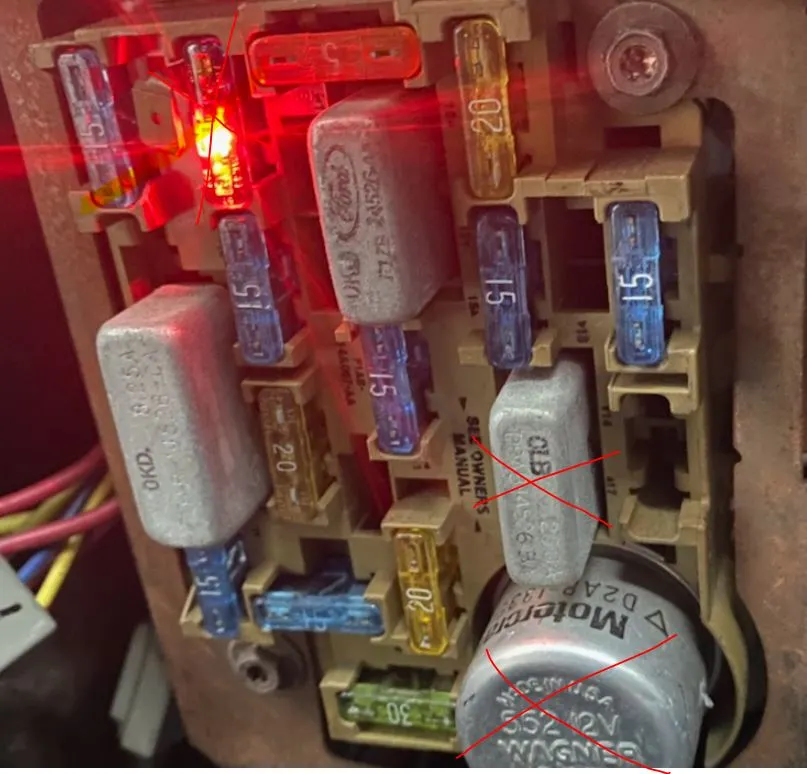

Hi All,
I have an issue were the left and right turn signals and running lights do not work in the front. No blinkers in the rear work. Running lights do work.
The hazards do work. In pic1 I have replaced the items that have a red X
The fuse with the light has also been replaced.
All new bulbs have been installed with new headlight hardness purchased from LMR.

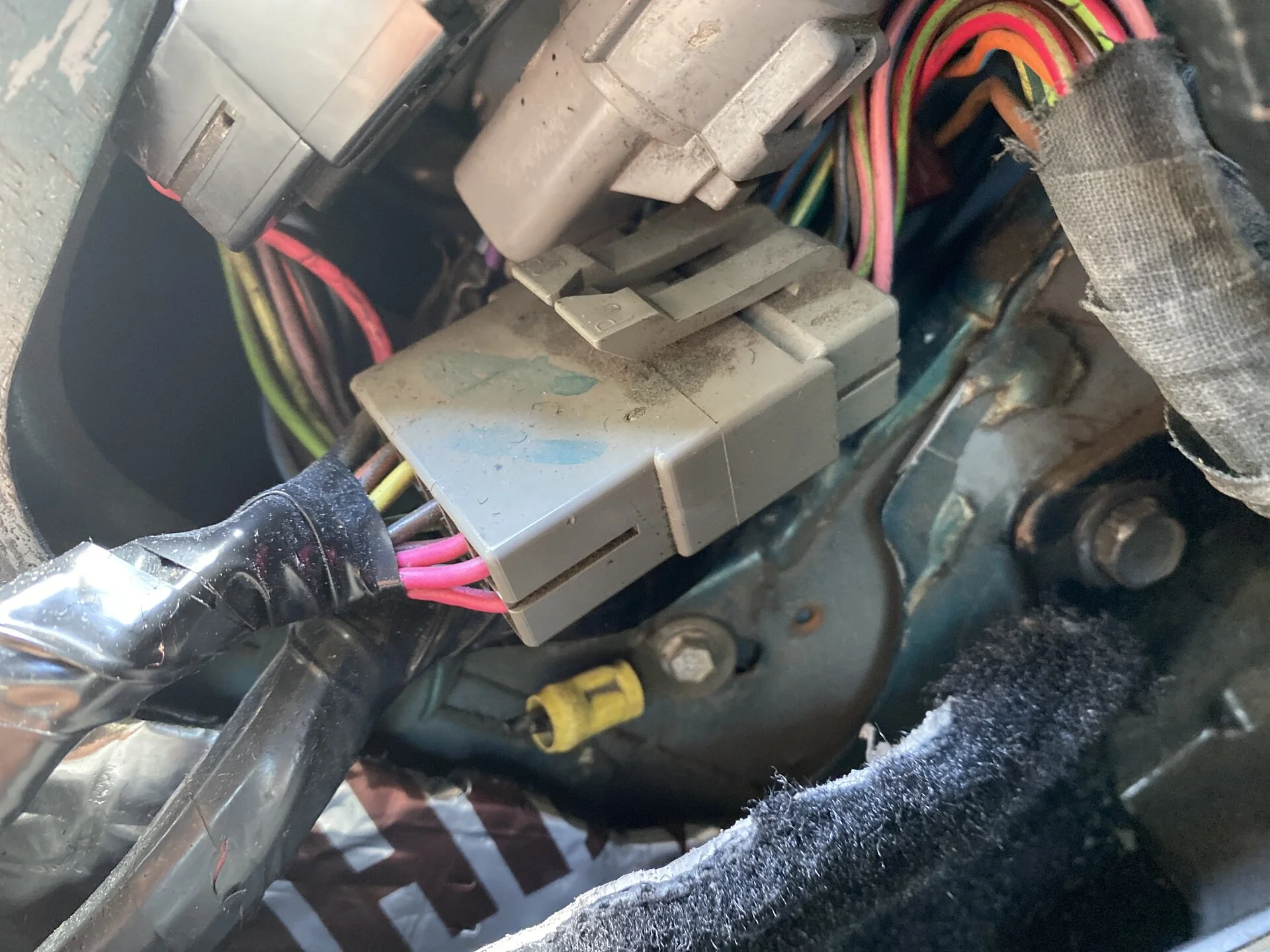

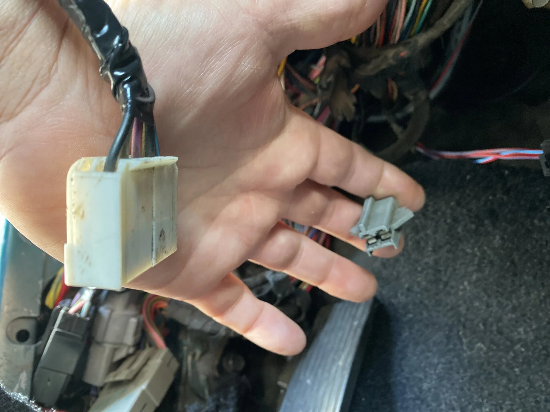

Your car may not use all those connectors depending on options like cruise and clutch.
The big white one might be the key in ignition buzzer
I would have you check power to each socket and out of the headlamp switch for the no park lamps issue

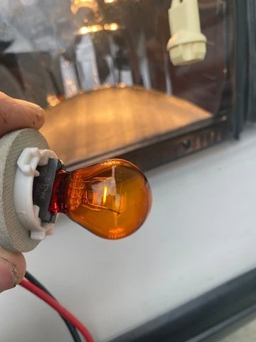

The wrong bulbs a possibility?
Socket failure a possibility

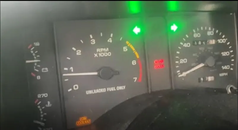

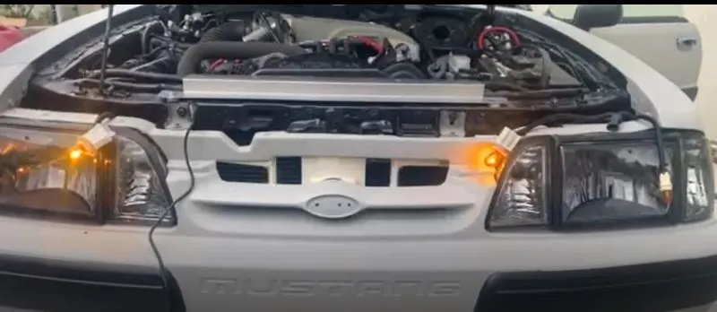

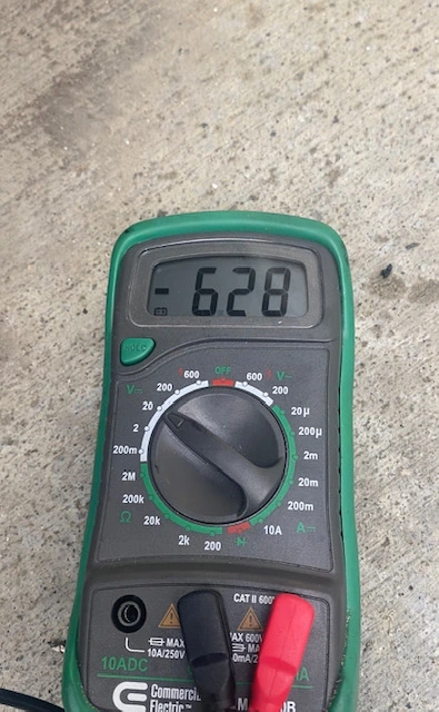

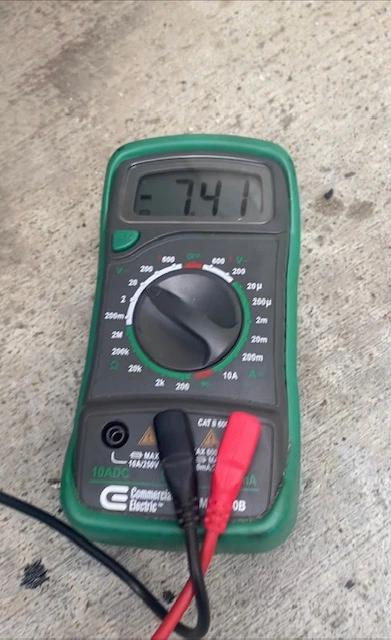

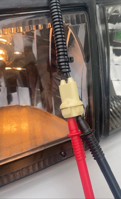

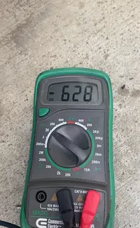

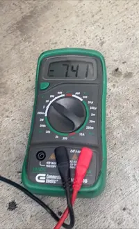

ok, so did some further testing.
As I mentioned the headlight harness is brand new from LMR.
1. With hazards on, the low coolant level indicator flashes just like the hazards
2. Driverside headlight flashes off/on like the hazards
3. if I turn off the hazards, and turn on the headlight the parking light is very dim
4. Checked the driver side marker light with a voltmeter and got 3.5 - 7.41 volts and nothing over while the car was on.
5. Replaced and test the new bulbs and replaced all the fuses.
Nothing was modified in the car. Just took out the old headlight harness and placed a new one.
