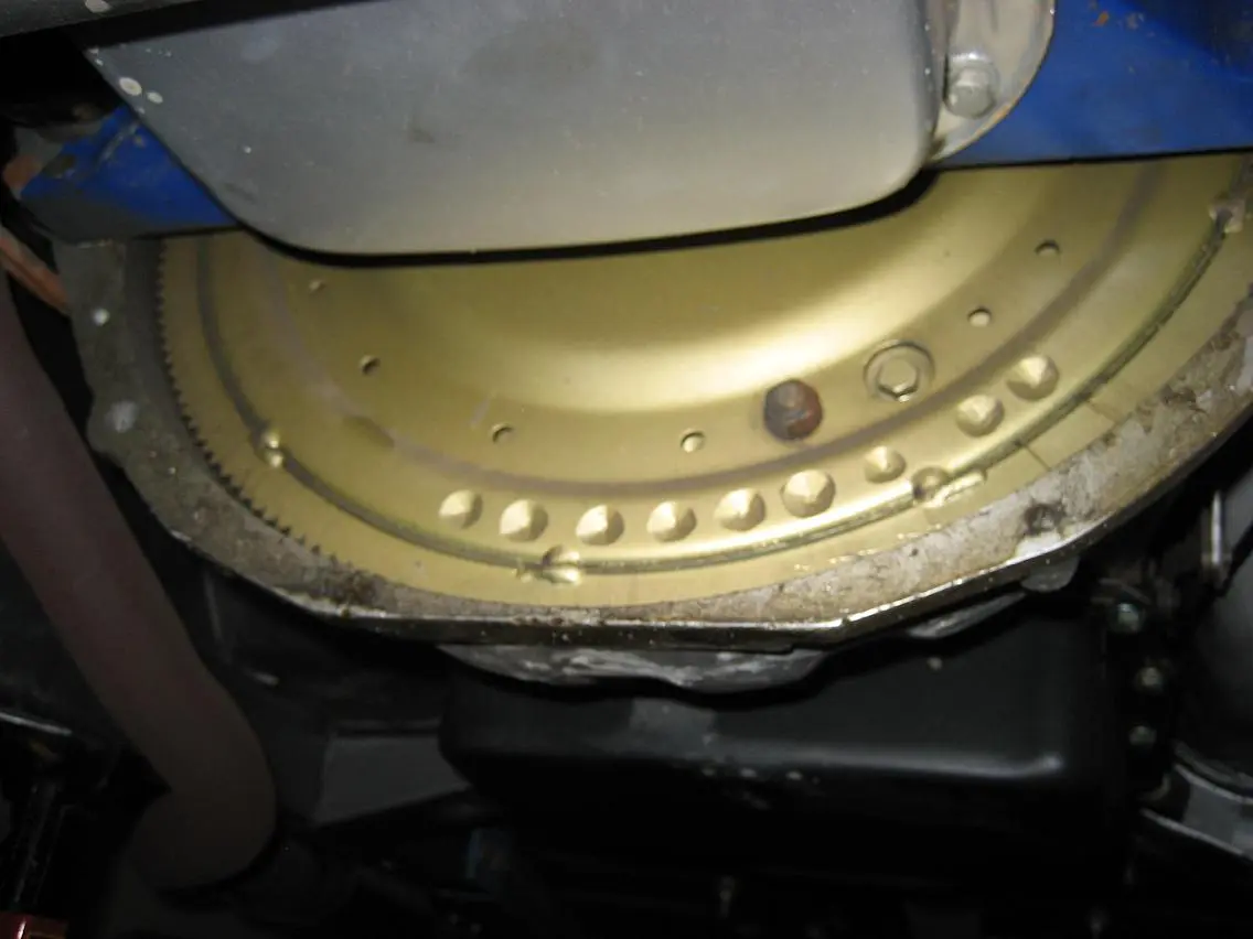

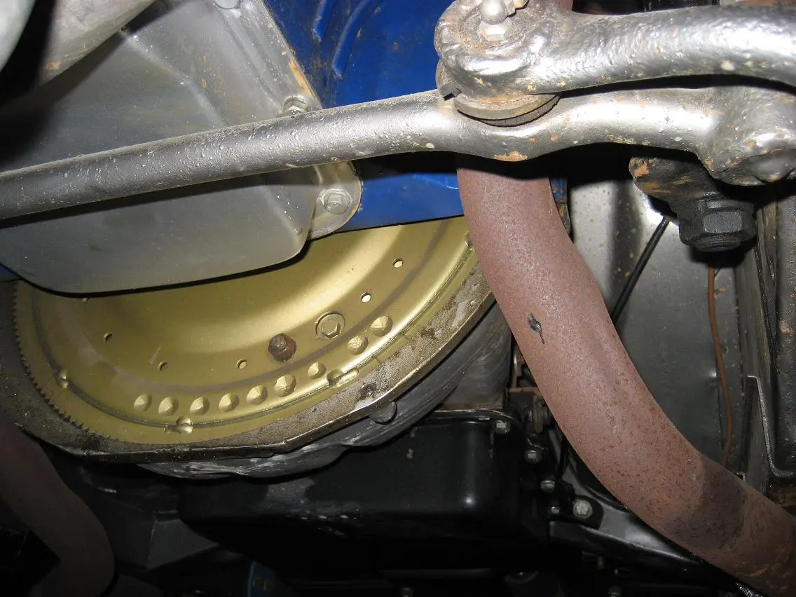

2. Second issue is it appears half the bell housing is missing. I've attached a picture showing what I see. Can anyone tell by the picture what's needed to cover that up?

Well you correctly guessed that it's a 390. The intake is a 70's part from a pickup truck and the exhaust manifold is a T-Bird part. The bottleneck in your motor is those exhaust manifolds. You might want to also check for a counterweight on the flywheel, the presence of one would indicate that it's either a 410 or a 428 motor instead of a 390. You're missing the dust cover from the front of the bellhousing. Try Mustangs Unlimited, they may stock that piece. No surprise that there's no casting numbers on the block, many late 60's FE blocks never had them.

If there's a counterweight there, you will not miss it. It'll be welded to the flexplate.
