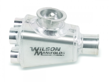

Here's what I use:
Wilson Manifolds coolant manifold is designed to allow for efficient cooling of your engine. Collecting coolant from both ends of each cylinder head provides uniform cooling while helping to eliminate dangerous hot spots. Consistent cooling also helps maintain repeatability round after round. Adapts up to four inlets into a single 1 1/2" hose outlet and includes a radiator cap provision.
