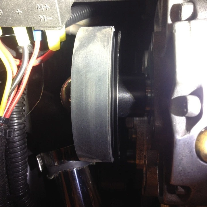

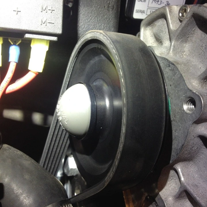

The belt at the blower pulley is walking forward one grove. Still drives fine but I dont like this. I followed all instructions installing the V3 kit. I did go to a larger crank pulley and had to buy a new belt. The kit came with a Goodyear Gatorback belt. The replacement I got was a Dayco. Maybe that's the issue. The belt is tight enough but still flops around a bit, even at idle. Maybe it's just crappy belt. I have a Gatorback on the way. Other than checking alignment and such, what things can I look to for a solution? I'm not crazy about the plastic tensioner that came with the kit.
