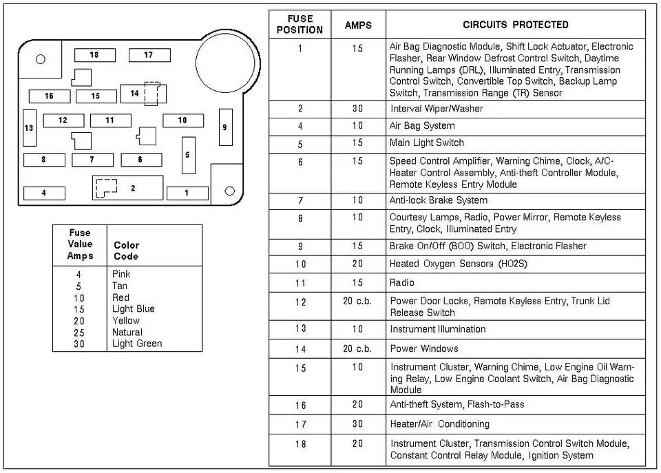

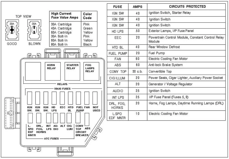

It started a couple of days ago, nothing comes through the vents. I figured look for some kind of fuse issue, but I don't know which one it is. Can someone post the fuse layout, and which fuse it is. Any other ideas or suggestions would be appreciated.
