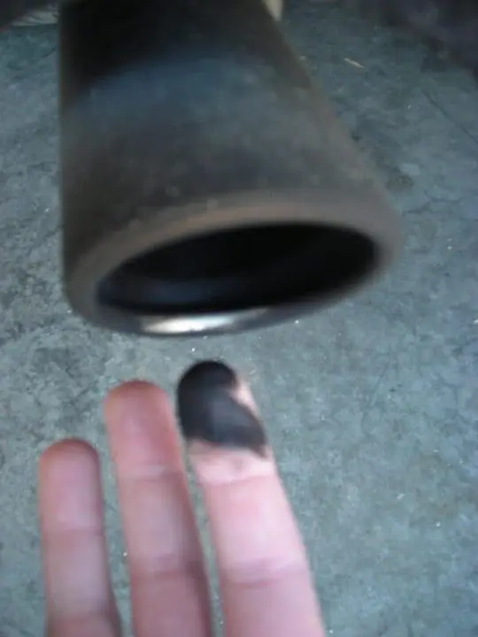

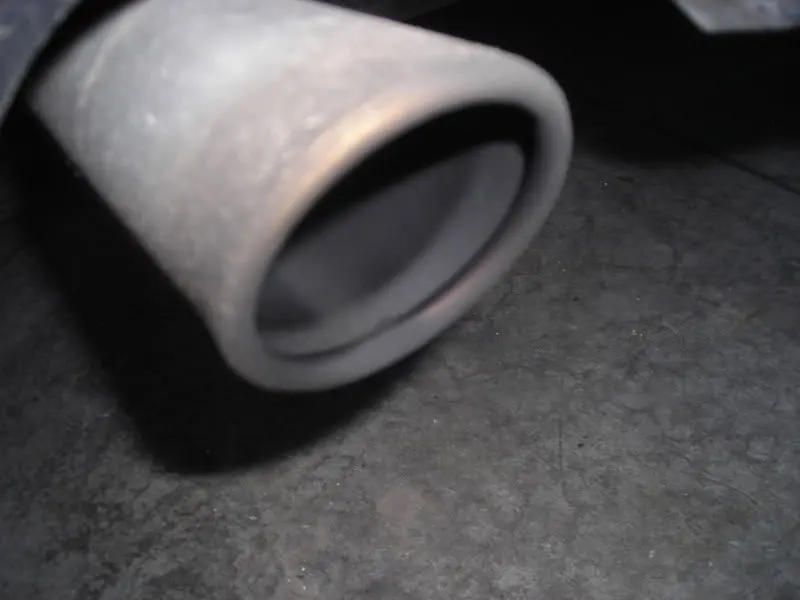

The soot thats being ejected is definately oil. I just washed the bullitt a few months ago and I THOROUGHLY cleaned the taipipes (i use an stainless metal polish) when I detialed her. I took some pics of the tailpipes today:
These arent real good pics per say but you get the point. I am changing the spark plugs soon so I'll get a good idea of which cylnder is having the problem by the color of the plug. Plus I might as well get it compression tested while im in there.
