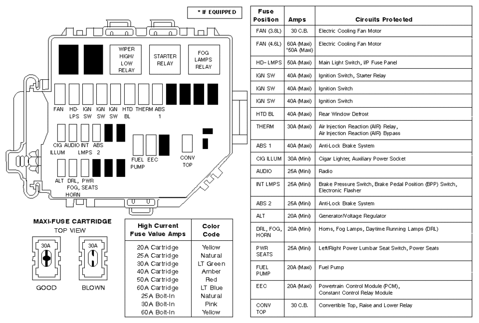

My 98 GT decided not to start one day. I brought it to the dealer who said it was the security system. They got it out of theft mode and it still wouldn't start. Then they said it was the fuel pump, so I swapped this out myself to save over $400. The car's still blowing a 20 amp fuse located in the engine bay. Does anybody have any clue why this is happening? I've been fighting with this for two weeks now... I'm in need of serious help.
I am using the ford EVTM manuals for your car and it does not list the fuse by number.. can you pick the fuse out of this picture

after finding the fuse youre blowing, find the route of that circuit. me thinks you have a short to ground somewhere in the circuit, possibly with the load (component being powered). let us know
