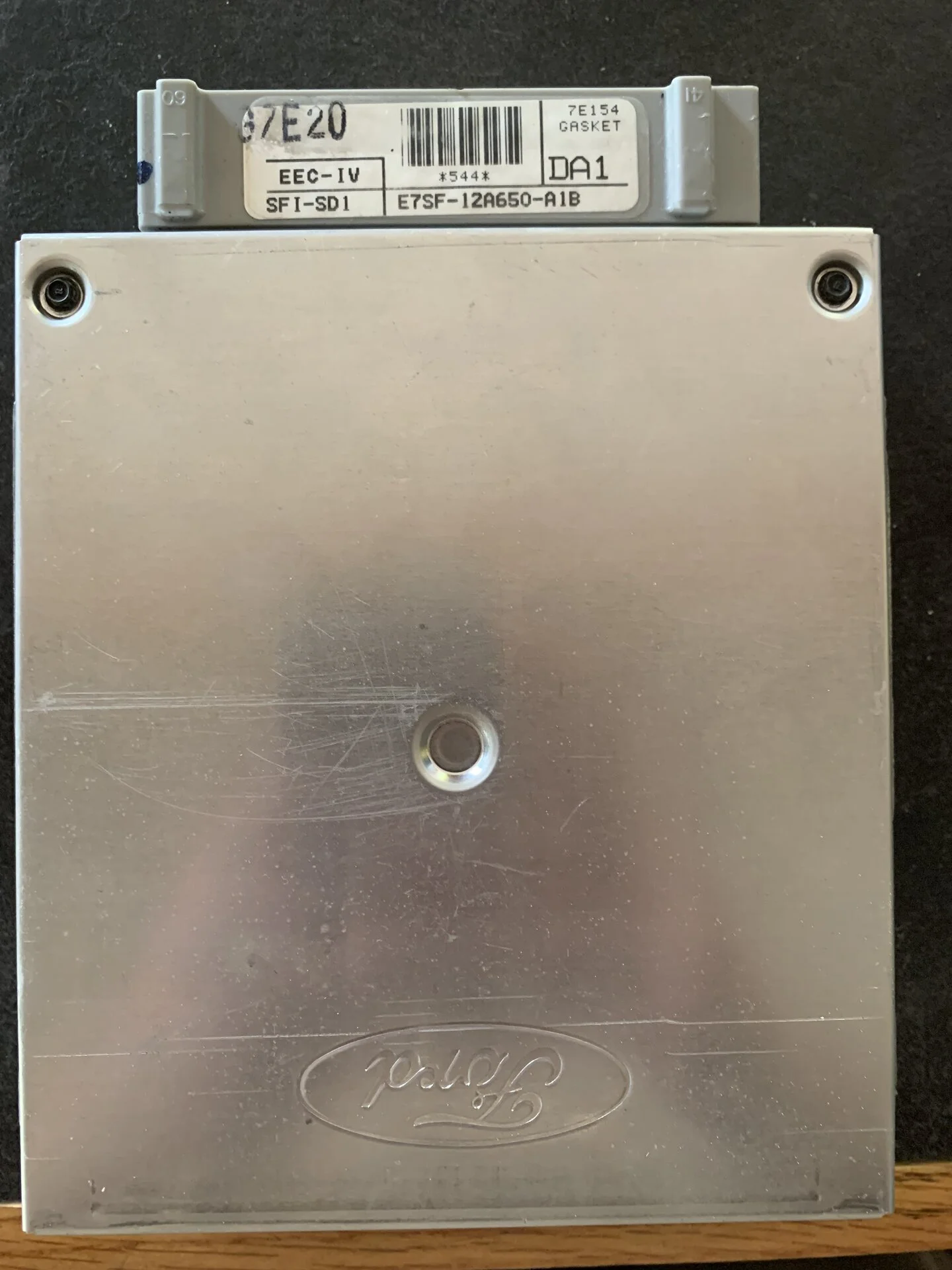

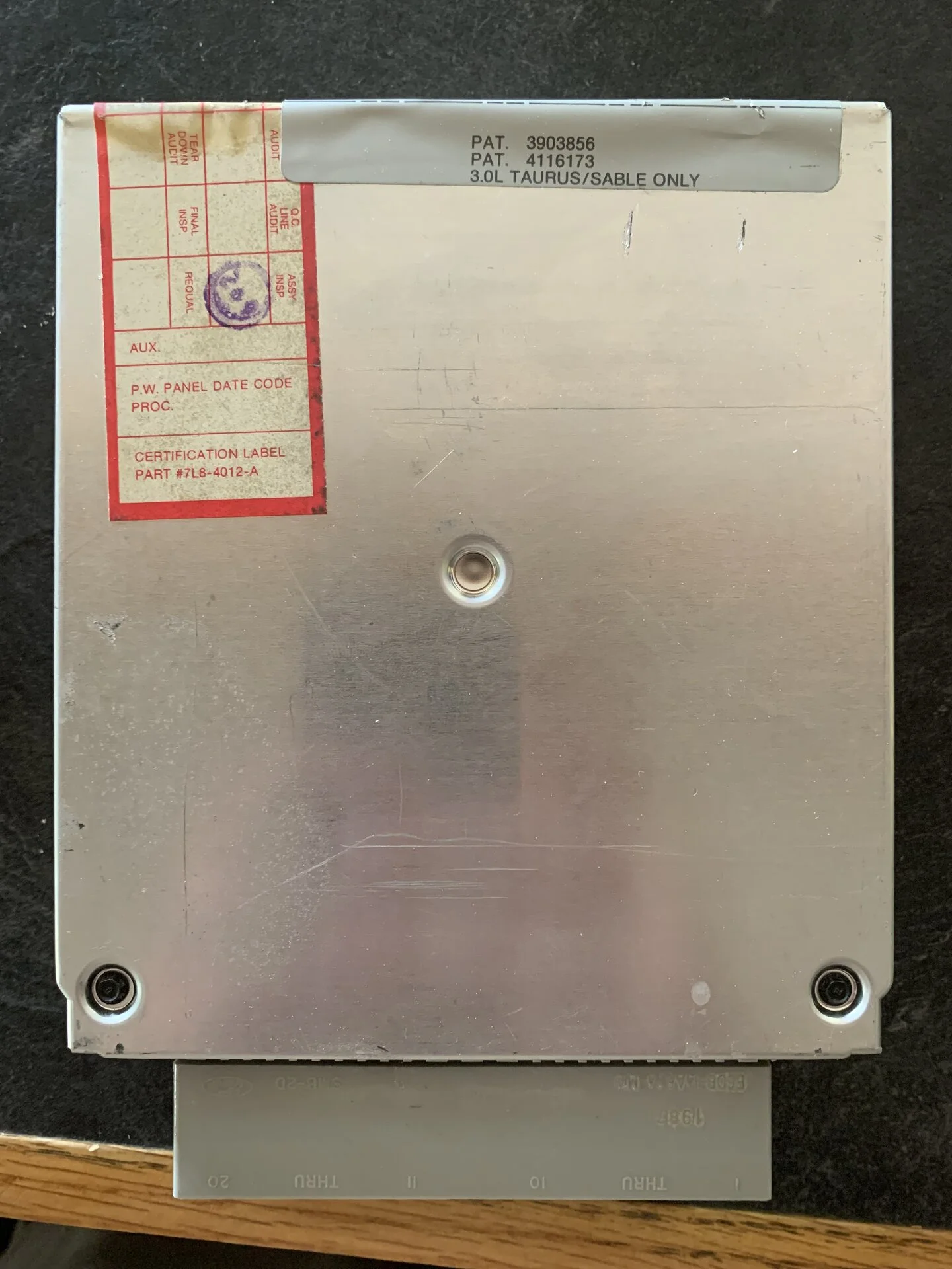

Please post a photo of what you are looking at.
Ford did stick these ECUs in a number of vehicles and some sharing was done. I’ve seen the 3.0 Taurus sticker a few times and it’s due to parts sharing. Your car wouldn’t run with the wrong ecu.

That's what I couldn't understand,
There would not be enough driver things in a 3.0 (6cyl) computer to operate an 8 cyl engine, right?
Wouldn’t even run due to firing order and it’s also speed density.
Ok the backside of the connector is a dot matrix part number that frequently cross-references the Taurus. Often times if the ECU label is missing folks assume this is the ECU part number when it’s really just the generic 60-pin connector part number.
That’s why I ask to see a pic to understand how folks are arriving at that conclusion
