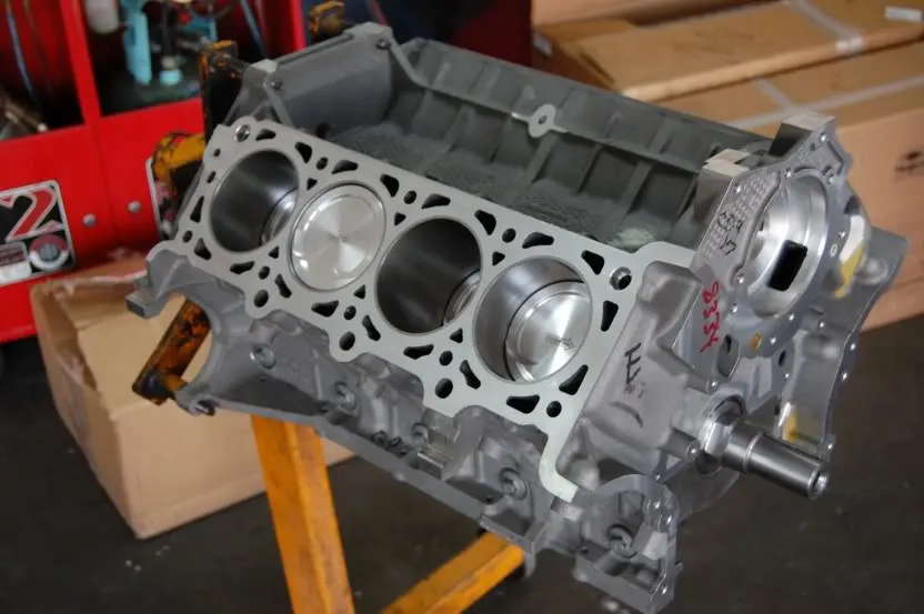

Ok so my 2004 gt has a vortech t-trim and a recently found spun bearing. I could either waste like another 1000 dollars or get a short block. But I hear they are a bitch to install. Any info or suggestions on what I should do or shortblock to buy Im thinking about this one MMR-800 - MMR 4.6 Street Mod 800 (up to 800HP) 2V, 3V or 4V - Shortblocks - Mustang Performance Parts

Get MMR 900 for little more cash.
I agree 100%. Yes the MMR 800 is nice, but since they are on sale right now from MMR directly, the MMR 900 is only $100 more and I think you are getting better parts! Especially since you have a T-Trim, you might as well get a great shortblock so you should not have to worry about it agian :hail2:

The diff between the 800 and 900 is MMR's h-beams vs Manley h-beams. $100 aint bad considering the difference between the rods retail is more than that.
Putting new rods in and/or putting a new stock block in if it's messed up is nearly the same amount of labor as putting a new forged one in. You just have to transfer stuff over like all the pulleys, oil pump ect.
