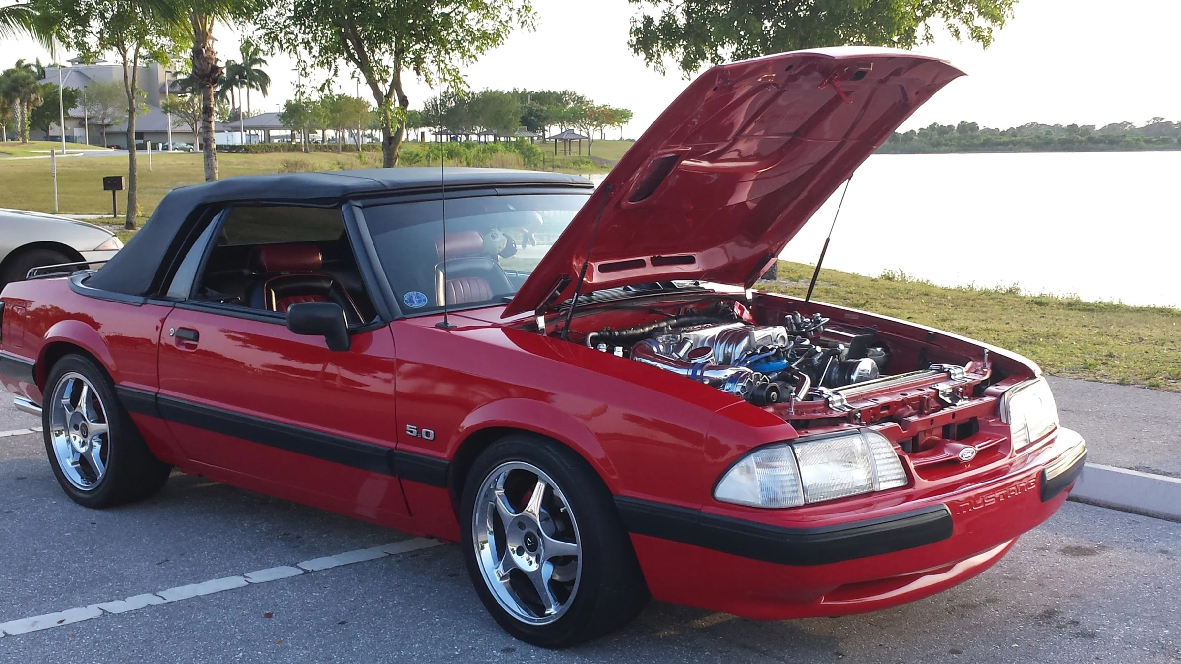

I kind of skimmed through a lot of this so forgive me if this has already been covered:
The t-stat has nothing to do with system temp:
If the cooling system is up to the task, then the t-stat will most certainly have an effect. With the t-stat wide open, if the car is not adequately cooling, then this of course, is not a t-stat problem.
Hot hot weather and.... er, humidity:
Radiators don't sweat (if yours does, there's your problem ). Real feel doesn't mean anything to a cooling system. 95 degrees is 95 degrees when the evaporation of water from a warm surface is not a factor.
Mike: Are you still running the OEM chin spoiler? If not, try installing one that is the width of the radiator and 2 to 3 inches tall. Get on the highway and check for a difference. If you're running any kind of inductive cowl, this should help quite a bit. The more negative air pressure that you create behind the radiator, the more airflow you're going to get while you're moving.
I would try this first before tossing bigger this or that, into the equation. You may even notice that the front end doesn't lift as much when you're going down the road at (1)55.
Just for chits and grins, can you post an image of your hood and the front of your car? Also...

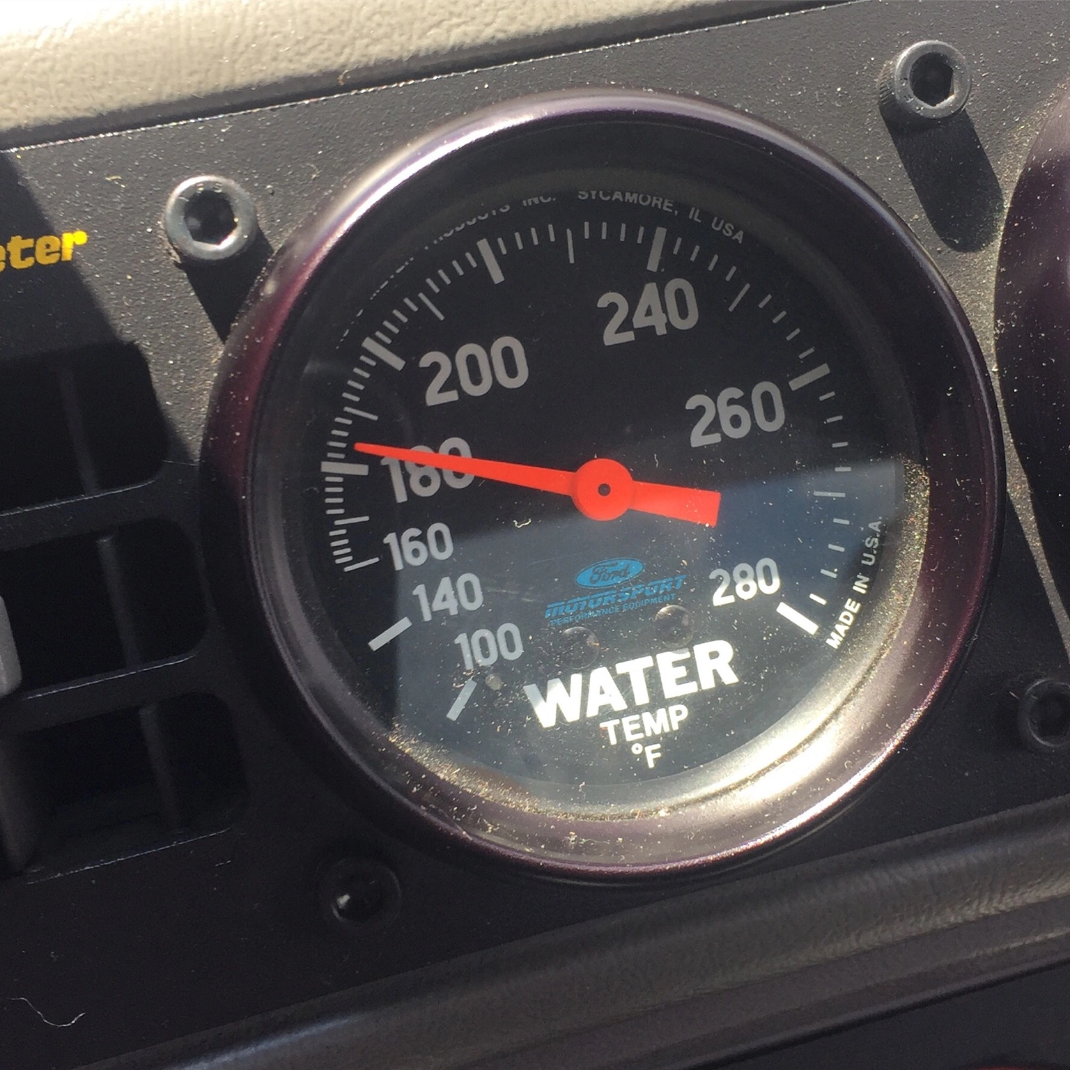

yeah noobz- it may be just me
Car wil be fine and the temp starts creeping up after 15 min from 180 to 195. On highway speed sometimes it will come down a bit, in hotter weather stays at 195 ish.
I ordered an aluminum replacement air deflector.
I have a ram air hood with a 1.5" cowl
I've owned several Vortech cars and this is the first one that I'm scratching my head on.
as requested.................
Reactions: a91what and Noobz347

The last time I chased this problem, it was on a car with a hood very much like that one (if not that very one. Stormin' Normin' hood?).
Is there some way that you can block the ports from the underside, without screwing it all up? All of the air volume that SUPPOSED to be going through your radiator and then under the car is taking the path of least resistance. Guess...
Edit: LOVE the pics BTW. Super sharp.

Thanks man... I call it the money pit.
Eh. you want me to plug what? Not sure how plugging off them would impact air from under the car going through the radiator? . Wouldnt that make the underhood temps hotter. I installed the new Alum air damn.. Much stiffer than the stock one and sticks down about an inch more... The new larger overflow--- uh yeah slight problem.. the damn thing is too large it wont fit and I also had a bracket welded on to the side of the radiator with tabs that fit the existing overflow.I'd have to remove the E fan to get access to the bolts that hold on the overflow.. plus I have a chrome lower rad hose that the larger overflow may hit.... Before i dig in and remove the fan. hose, fab up new brackets,,,,, I'll take it for a spin with the new air deflector,
