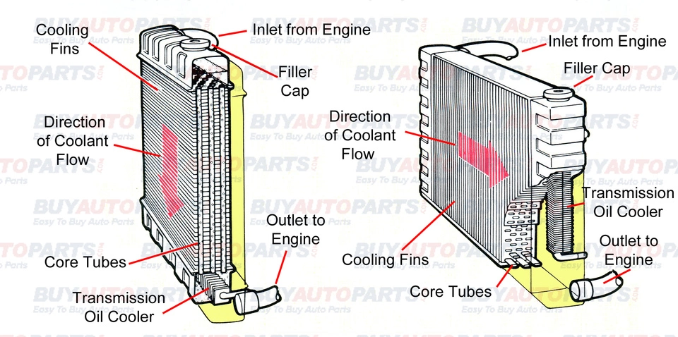

The hot coolant comes in from the thermostat and then into the upper hose on the passenger side and then throgh the radiator and then out the driver side hose to the water pump. That is why the drive side is cooler.
  • If the lower hose is collapsing then it is restricting the flow back to the water pump
  • if the thermostat is sticking in a closed or semi closed position that will restrict the flow
  • if the thermostat is stuck open, the coolant does not have suffficient time to flow through the radiator and dissipate heat
  • Did
  • if you have air in the system then it will create a hot spot
  • if your overflow is missing, the tank is cracked, the hose kinked or blocked then that will cause the temp to be higher.
  • If there is a leak in the system then that will lower the boiling point
  • If the cap doesn't hold pressure that will lower the boiling point
