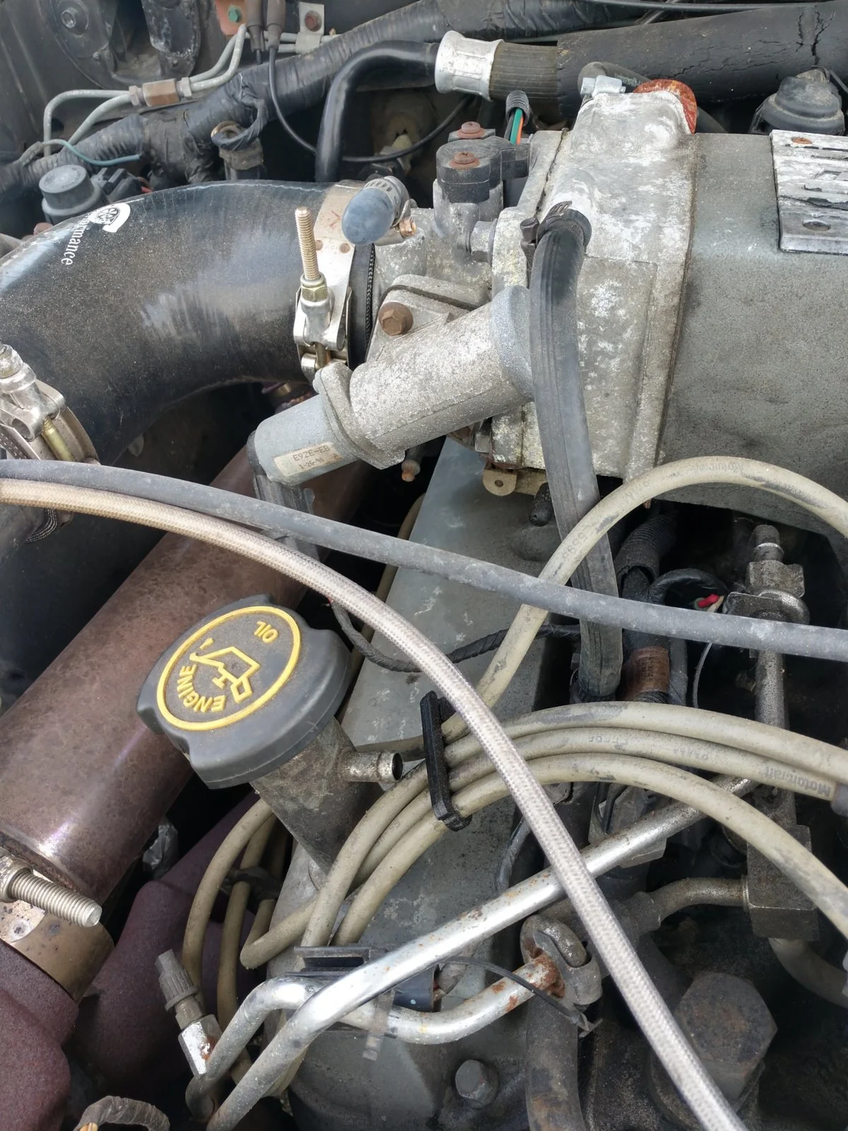

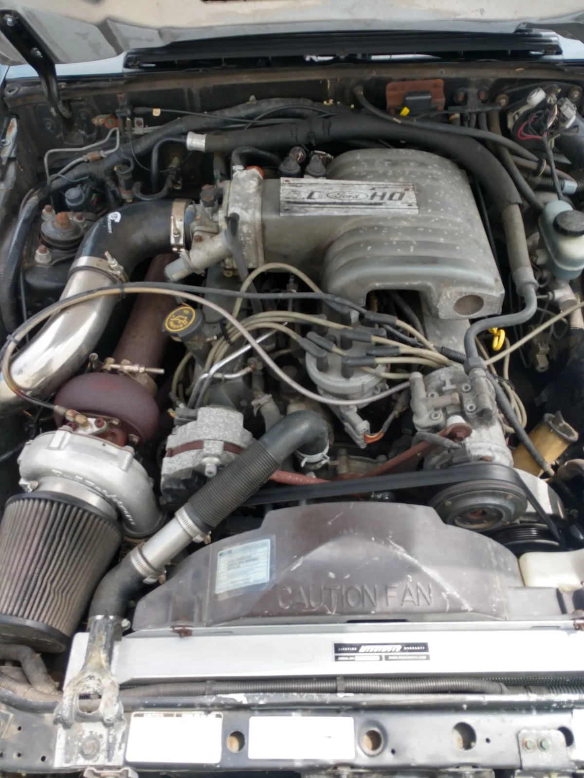

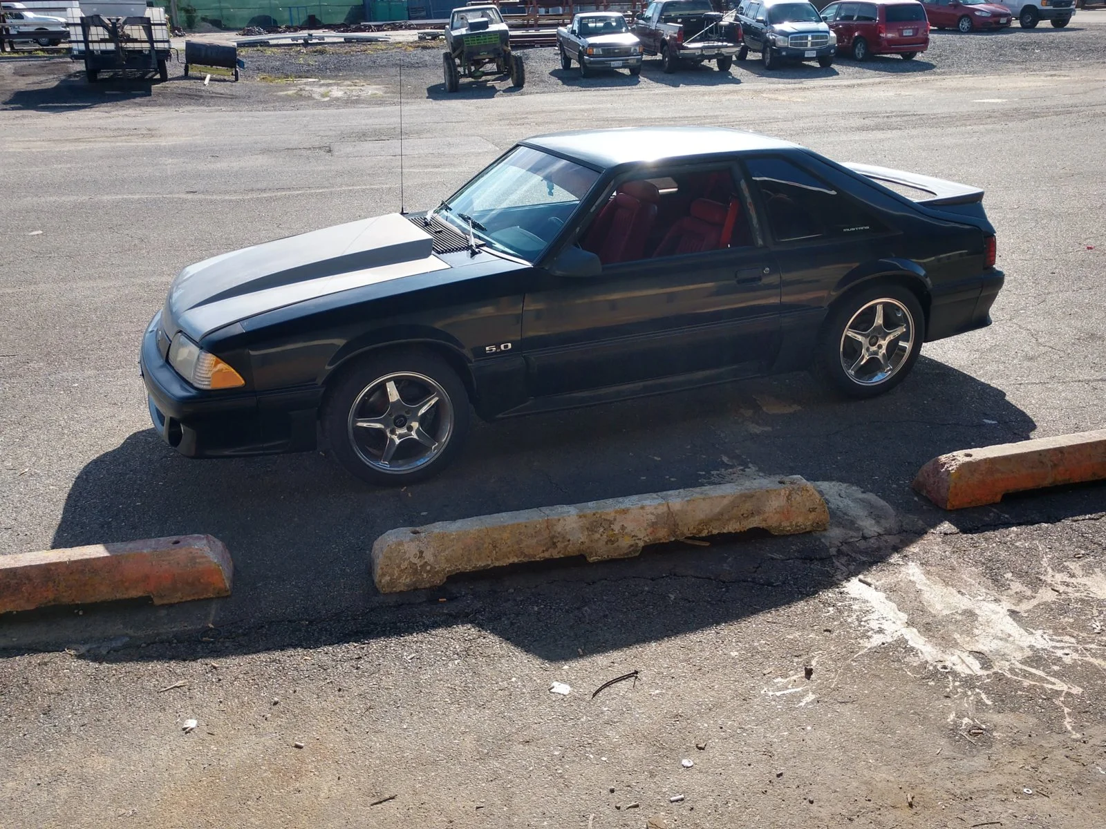

90 mustang GT,5.0, automatic with a turbo. I noticed the exhaust and fuel system has been upgraded. I also noticed a vent line not on there. I'm not sure if it's because of turbo or just was left off. This car is very clean and very fast. I also need to do a head gasket job on it. I'm looking for any advice,pointers and maybe a step by step head gasket procedure. Thanks

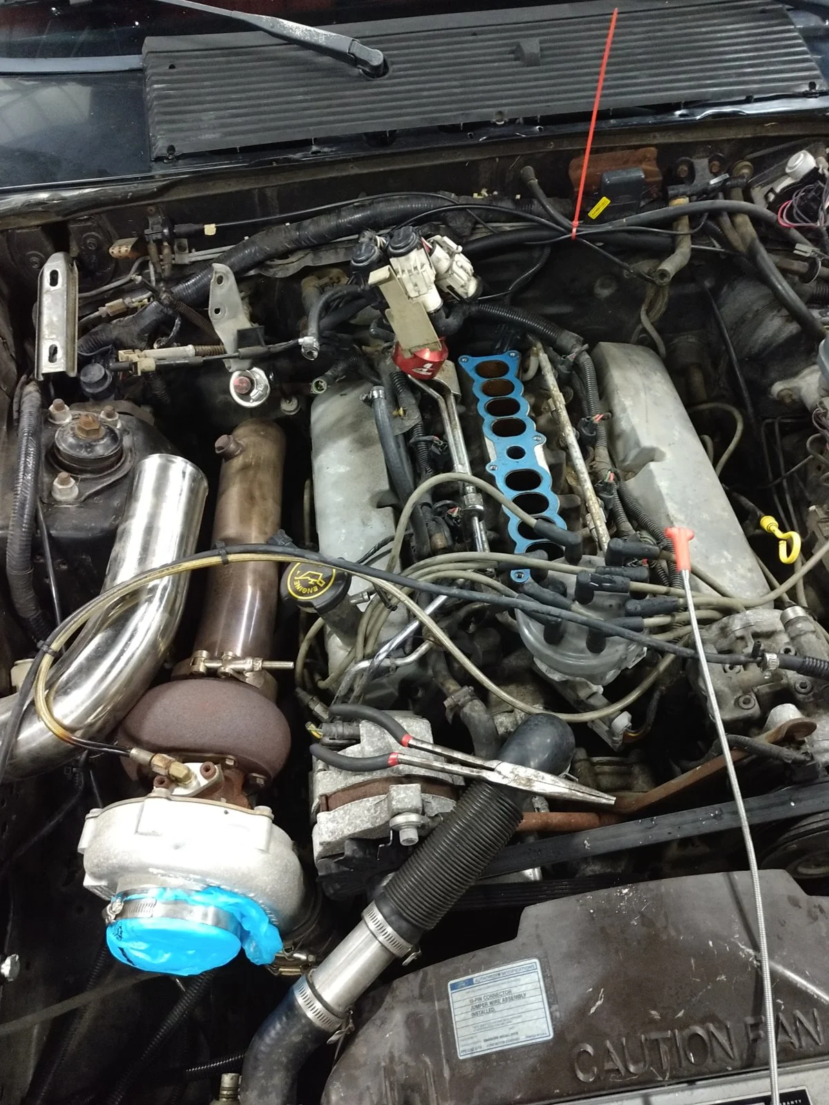

Cool project. Things I noticed right off hand....a/c isn't hooked up, heater core has no lines going to it, and you have an open tube on your oil filter neck that should be hooked to the throttle body.

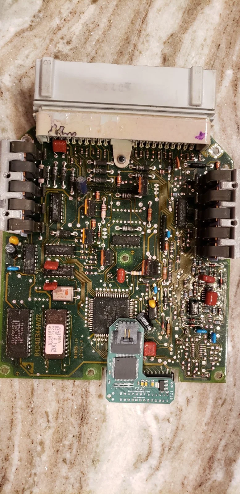

Cool project! Pretty nice looking car. Has anything else been done to the engine besides the turbo? Have you pulled the computer completely out to see if it has a chip installed?

As far as I can see just the fuel system has been upgraded and fuel pressure regulator. I haven't pulled the computer yet. I will do that as soon as I can.
Oil fill port should be capped with forced induction.

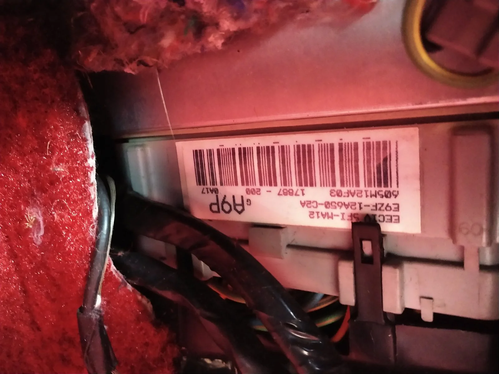

What ECU is running the engine? I don't see a MAF
Given that it's on the lower end of the motor, it's probably not hurting anything, but perhaps is making a mess. Most of us gave up on trying to keep a seal and a vacuum and run breathers instead now, anyways. Guys sometimes run a breather right off the top of that instead of the oil cap, too.
