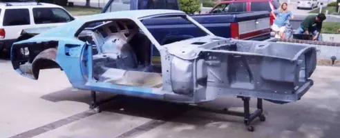

I made a body dolly out of 2 X 2 steel tubing. I made short uprights to where the lower control arms mount and to where the front of the rear springs bolt to the body. I made it so the body would be as level as possible, but I also went slightly overboard and made the chassis mounting points with screw type adjusters so the body could be further leveled it need be. I used some fairly heavy lockable casters on the front and solid wheels on the rear. Sorry i don't have any pics and it is currently at my body guys place which is an hour away. If I get over there soon I will take some pics.
Mine is made from 2"x2" steel tubing. The mounting points are the lower control arm bolts (Front) and the front spring eye (rear). Works great.
My set up is very similar, except I didn't go as far forward; stopped at the firewall so I have enough room for my front suspension upgrade. I found some 3x3 ~3/8" steel tubing at a steel yards junk pile. Worked out great. Oh... make sure you get good casters that can support the weight of the car. <--- learned lesson on that one :rolleyes:
