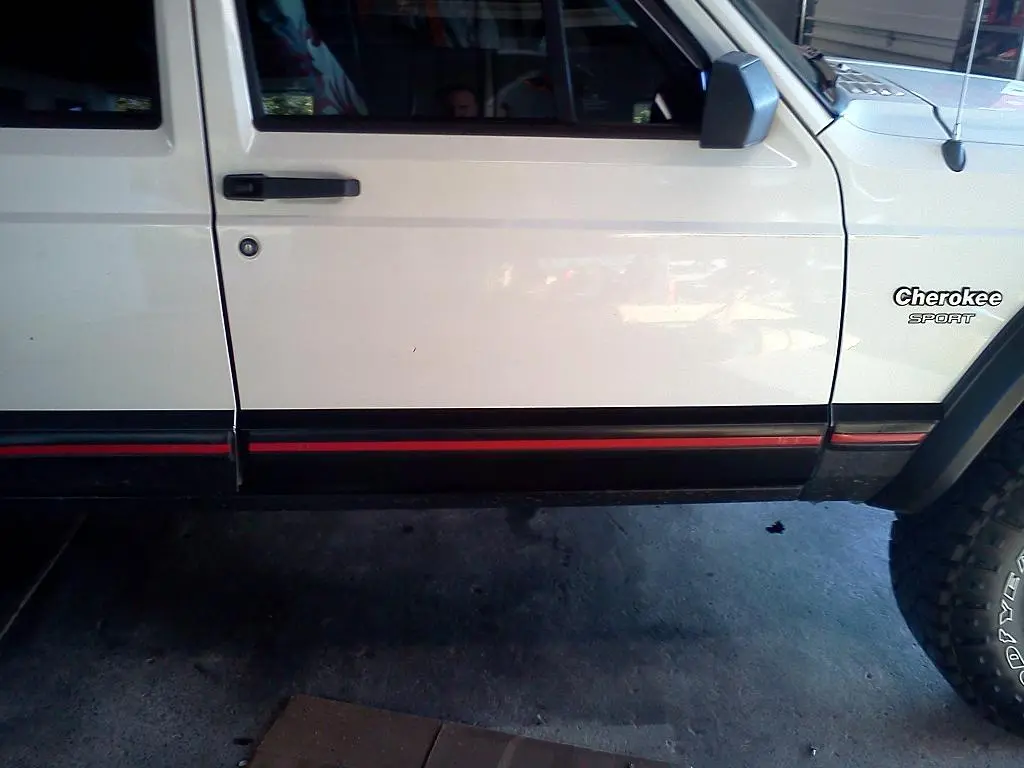

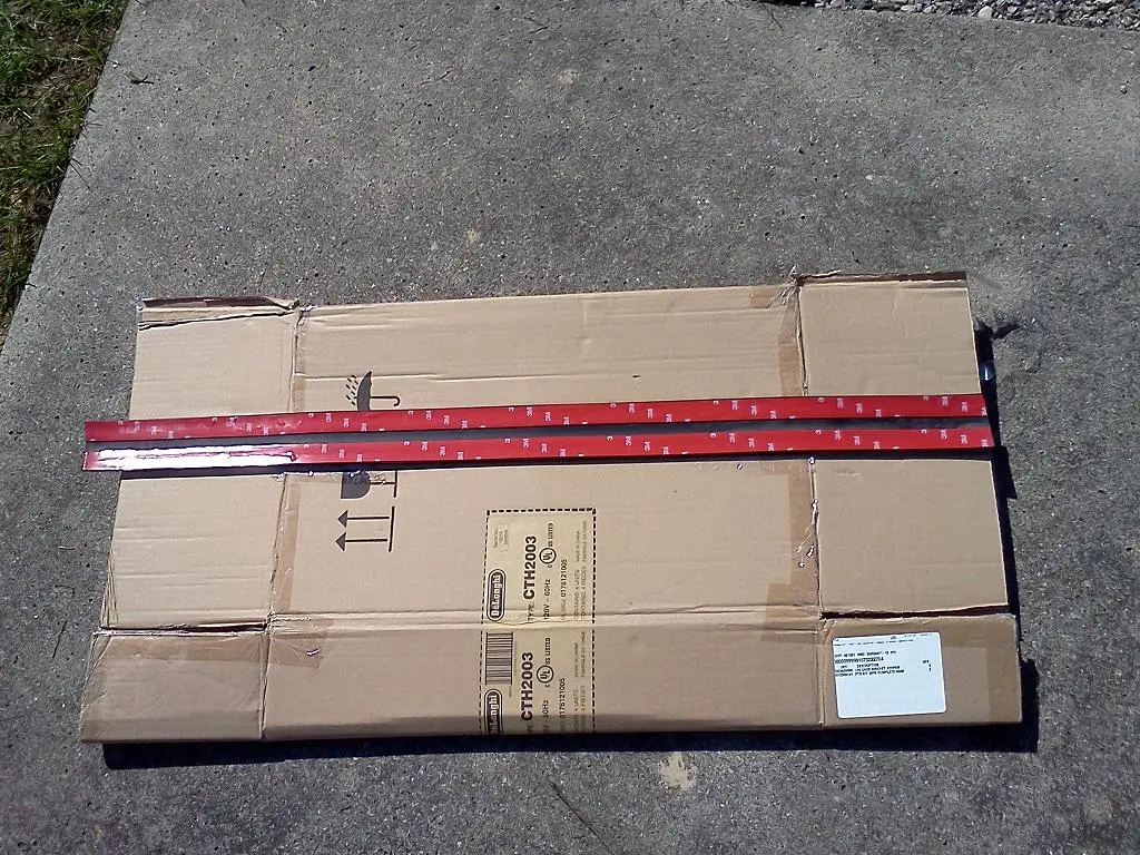

Not a Mustang but a recent repair. Yes they all need done. I painted the door black trim as well.
