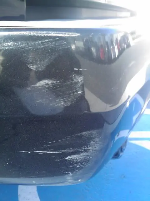

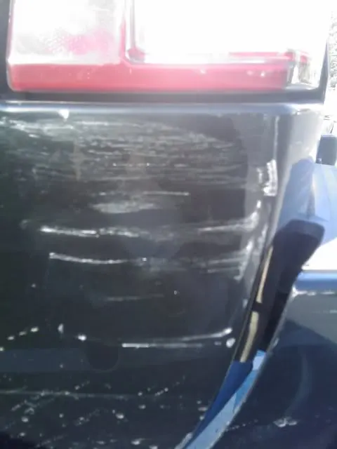

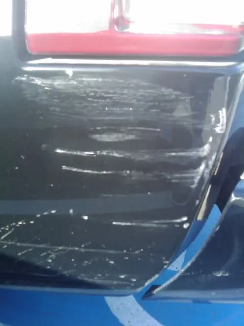

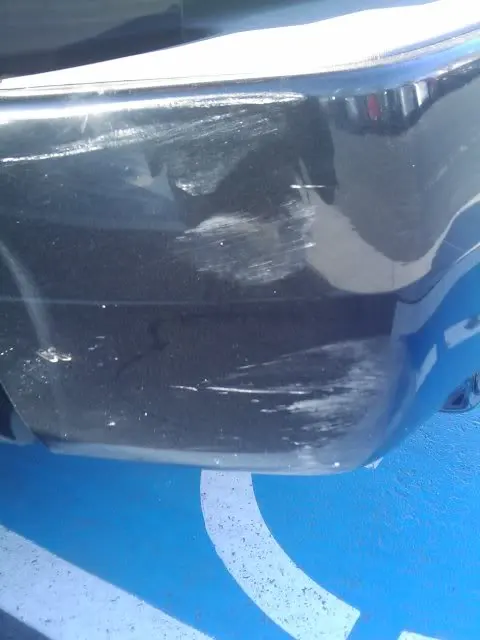

Someone hit the back of my escalade, I think it might of been at school. I really dont no when it happened I barley noticed it when I was putting gas neways. I dont want to go thru my insurance to fix it so how can I go about cleaning these scratches and scuffs up, there is no dents, just a that big chip that kinda came off. I already used a mr clean magic eraser and that thing works really good.. it removed all the paint transer off(other car was green)

You could wetsand with 2000 grit and buff. Need to be carefull you don't take too much clear off though. It's hard to tell in the pic how deep the scuffs are. There may be some you can't get out if they're too deep.
how to i tell how much clear coat im taking off while sanding
Well, that can be tricky. I wetsand with a small rubber block for a repair like that. Go a little at a time and then wipe it down and squeege it off with the rubber block. You'll be able to see the the clear coming down. It'll haze and you'll be able to see the deeper scratches through it. As far as the thickness of the clear coat, it's usually about 2 mills on a factory paintjob if I remember correctly. Very thin. You could remove too much and do more damage. If you're not comfortable you may want to stop by a body shop and see if they can determine the depth of the scratches and maybe get a price on what they'd want to do it.
dont even wet sand it, just use some buffing compound and see how that turns out first. use the least aggressive methods first, then move to sanding it after all else fails.
with 2000 grit sandpaper, it would take you much more time than you are willing to put in before the paint will be too thin.
Buffing is a waste is you aren't to the depth you need to be to remove the scratches. 2000 grit paper and a block sander will remove a more uniform and controllable amount of clear. Then it will only require minimum buffing. Whenever I buff any coating for the first time, it goes to 2000 grit paper block sanded first. Then it only require a mild abrasive compound to bring it back.
