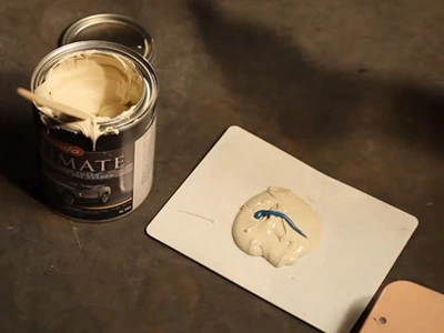

I've never had issues with Bondo brand. With that being said, care should always be taken to use the proper kind of filler for the application, and mixing correct amounts and paying attention to drying times corrected for heat and humidity is important.
Grabbed this pic off the internet. It is close but a bit much for my liking.
