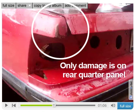

I'm thinking about buying this car, its a 91 lx convertible. Can anyone give me a rough idea of what I'd be looking at to have this damage fixed? Thanks for the help!

Just replace the whole piece. You can buy the rear quarter for ~$170. This way you don't have any hidden rust in the quarter. The quarter is going to have to be cut out and the new one welded in. The real world price for this job and paint is arount $1500 to $2000 for a professional job. It is going to look silly though because one have of the car is going to have new paint and the other half is going to be faded red. So, if you were going to do it right, just get the whole car painted.
One more thing, look for rust on the deck lid (trunk). It likes to hide in the folded seam on the deck lid where it meets the taillights.
Thanks for the info. Do you know how tough it is to remove the panel? What do you mean when you say "cut out"? Are they welded in?
FYI- I do plan on repainting the entire vehicle.

1500ish, that thing is beat
that one little spot could be pulled and straightened fairly easy. The paint won't quite match up, but a good painter can match faded paint fairly well...Not worth replacing a quarter skin for that little corner. Take it to a shop for an estimate....they are generally free.
