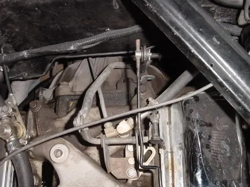

I took a 1/4 NPT 90 degree to 3/8 inverted flare adapter for the brake booster, and I drilled and tapped it for 1/8" NPT 90 degree to 1/4 inverted flare adapter to the trans.
It's been working for a few years.
