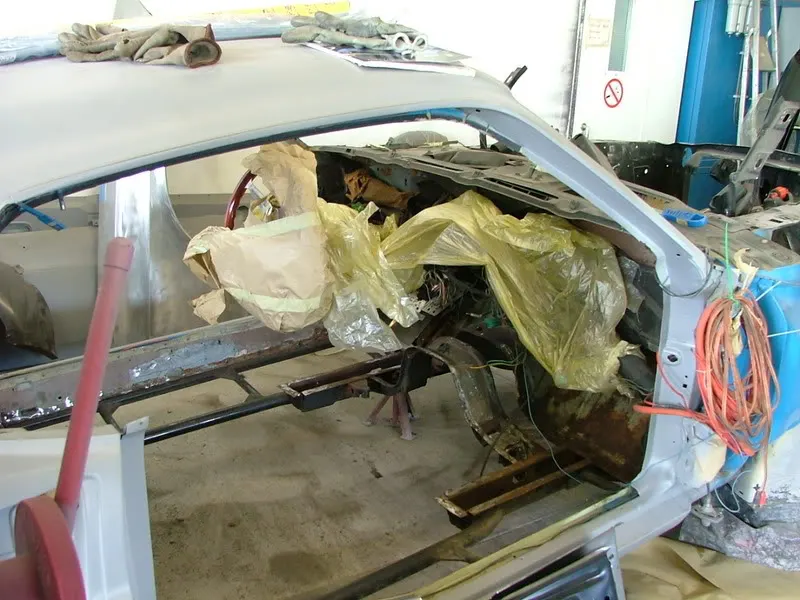

Welded, without a doubt. I have Global West subframes with jacking rails, that you can see in the pic below this text. I crashed my car in Nov. 2006 and the informed opinion of my mechanic and body guy were that the subframes and jacking rails were the only things that kept my car from ripping in half.
