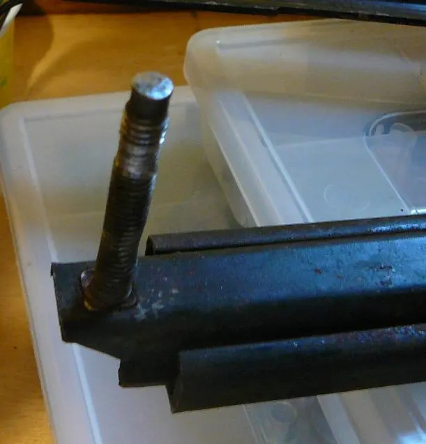

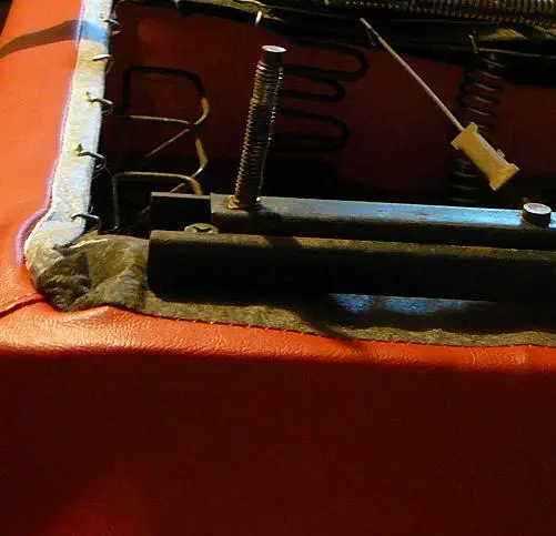

I have a stripped bolt on the bracket that holds my seat down. I have tried everything I can think of to get it out ... I banged it with a hammer, and heated it up with a propane torch ... no luck.
Should I cut it off and try to drill it out with my drill press?
i love my drill press! it was not welded in there. once i removed enough of the top (ie- the square part), i was able to bang it out with the hammer.
a hex bolt fits in there well enough that it doesn't turn and i can get a nut on it
