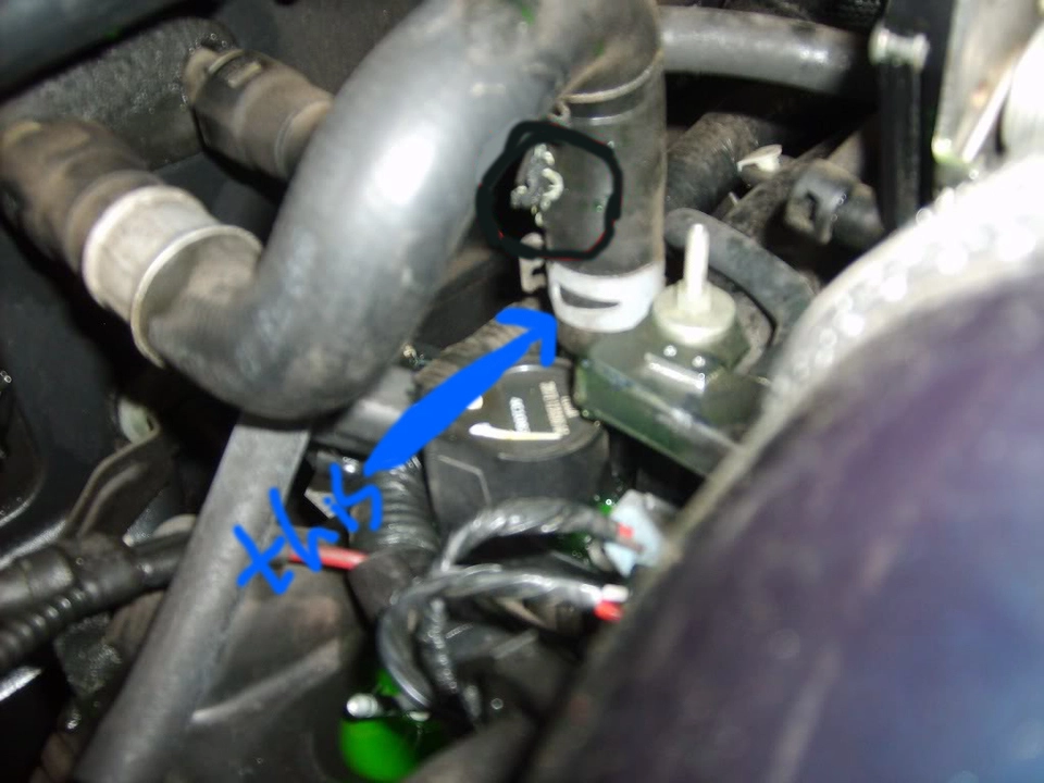

hey hey guys, guess what , I think I nearly killed my car.
driving around about 120km/h getting out of an exist , and I smelled coolant , luckly a gas station near by is where I stopped about 45sec after I start smelling it,
opened the hood , to see the engine bay filled with water , ( again , I think I am lucky , nothing on the alternator nor on the fuse box and other (water hater parts)
anyway , I found a photo online for the part where I am leaking , (as I forget to get my own photo , and I am toooo lazy to get my *** off the couch . )
so here is the photo
please ignore the black lining , and look at the BIG BLUE ONE
inside the hose there is a plastic pipe , attached to the engine , this plastic pipe is the broken part.
can someone help me find the name/number of that part , also , can I just get my self a longer hose and tie it well ... ?
thanks amigos :D
I believe the pipe that hose is connected to is actually molded into the intake. Im thinking your going to have to replace the intake. Hope I'm wrong but I changed my intake a short time back and I pretty sure that is the case. Good luck
well thank you so much , as you said , look like it's time for new one , I did some readings about them intake manifolds online , and look like I am going with the metal ones for example the "Professional Products Satin Typhoon Intake Manifold " from A.M , for 540$

That's the correct intake. Perfromance Improved from Ford Racing is the intake. If your gaskets aren't damaged in the process of removal, you can re use them. I replaced all the gaskets when I did mine but my car is over 100xxx miles. I thought it was a good idea. The only gasket I absolutely had to replace was the EGR gasket. Its dirt cheap even from a dealer.
I didn't have a write up but if you are at all mechanically inclined, it is a simple process. Remove the alternator. Take everything off the top of the intake. Mark your vacuums and electrical connection with masking tape and a sharpie. Replace intake. Bolt everything back on. Be sure to inspect the coolant line running thru the engine valley while your in there. If it looks a little worse for wear, replace it while your in there. Mine was still in great shape though. It may be a little intimidating at first look, but it really isn't that bad. I think I used 1/4" drive ratchet set to do almost the whole thing.

I guess I'm just cheap. I'd probably just epoxy the plastic tube back into place over a piece of copper pipe to strengthen the area and call it a day. :shrug:
LOL, I acually did that once with JB weld on my old 96' when it was still NPI until the new intake was shipped. I acually got lazy and it stayed glued together and not leaking for about 2 months when I changed out the intake.
