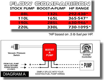

well in the email I got back from KB tech says "The BAP can be used with any Nitrous or Superchanged setup" but heres a diagram. From the specs it says the BAP is activated at WOT on N/A applications and at 3lbs of boost on turbo and S/C apps.

Wrong, the BAP may deliver the alloted amount of fuel under a specific voltage, but it's activates under boost pressure via Hobbs Pressure Switch. The stock switch comes on at approximatley 3.5psi, which unless you're running a really hard spinning centrifugal set up your fuel pump running it's stock voltage should be more than capable of handling.
then i must have mis-understood when it was explained to me how it worked

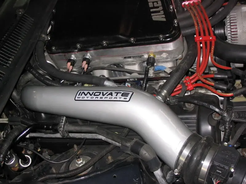

No prob. Just a little mixed up with a few of the facts. For the record, activated under boost and the amount of voltage seen is adjustable via remote dial located inside the vehicle. I located mine (hobbs switches 1 for BAS and 1 for BAP) in a fairly convenient spot. :D

Yeah, thats where I put mine too. Although I put my switches inside my armrest and are right there for you when you flip up the lid, for easy access. Not like I'll ever screw with them anyway. But hey, it looks cool? :shrug:
