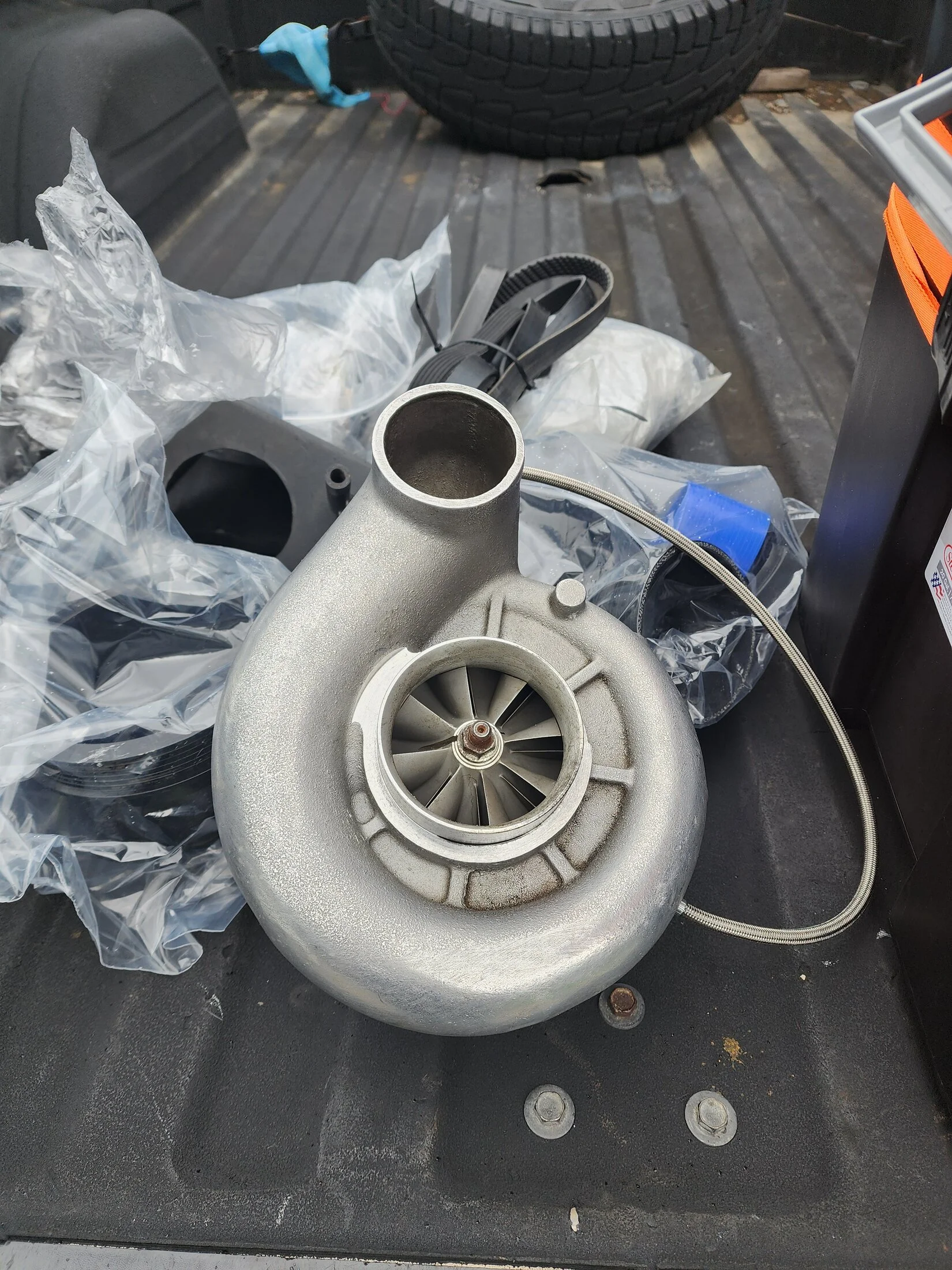

I just acquired a vortech supercharger for my five liter. (6 psi pulley) I plan on using 42lb inj w/ maf and a 255 pump.. what do I do about the factory fuel pressure regulator? Can I use it? Do I need to upgrade it? Do I leave the vacuum/boost reference to it? I'm not trying to break any world records just want safe reliable fun. I do not have an FMU.
Also, do I NEED a custom dyno tune to run it safely?
