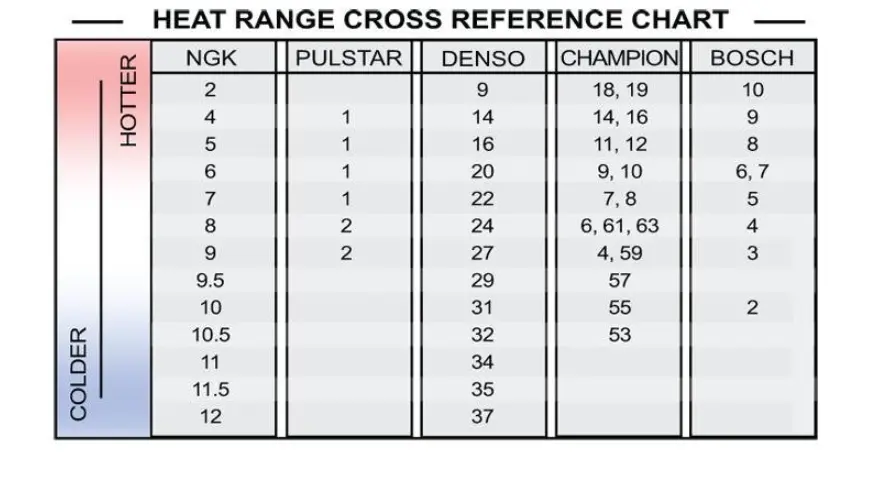

Whats a good recommendation for a rc12yc/ 3924 sparkplug for one heat range cooler
Admin Dude
Jan 4, 1985
43,535
21,704
Box behind Walmart
Jul 19, 2024
#27
  • Jul 19, 2024
  • #27
It should be an RC11YC:
But I think it's the RC10YC that you're going to find (after a quick Amazonia search).
