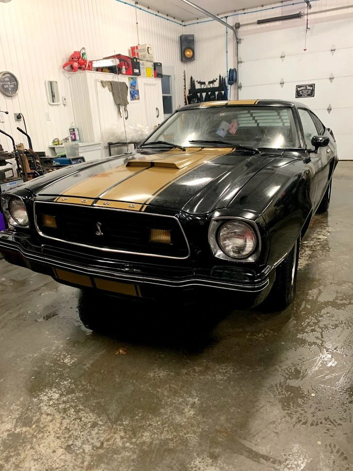

Hi I restore a 1977 mustang II with a manual transmission What kind of fluid and how many quarts need this kind of transmission I didn't see nothing about that in the Haynes book
