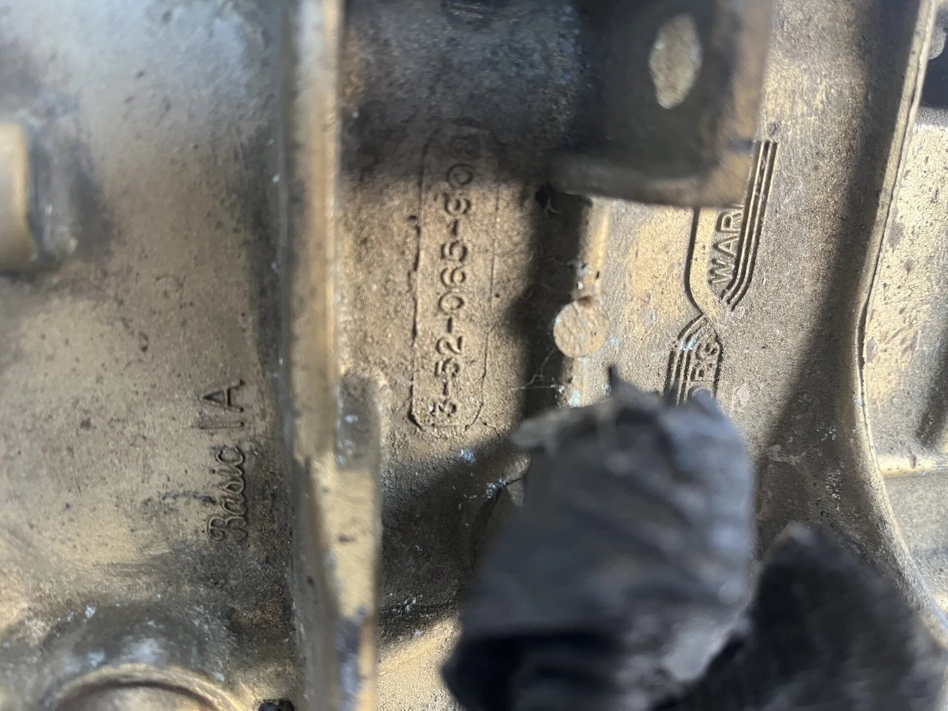

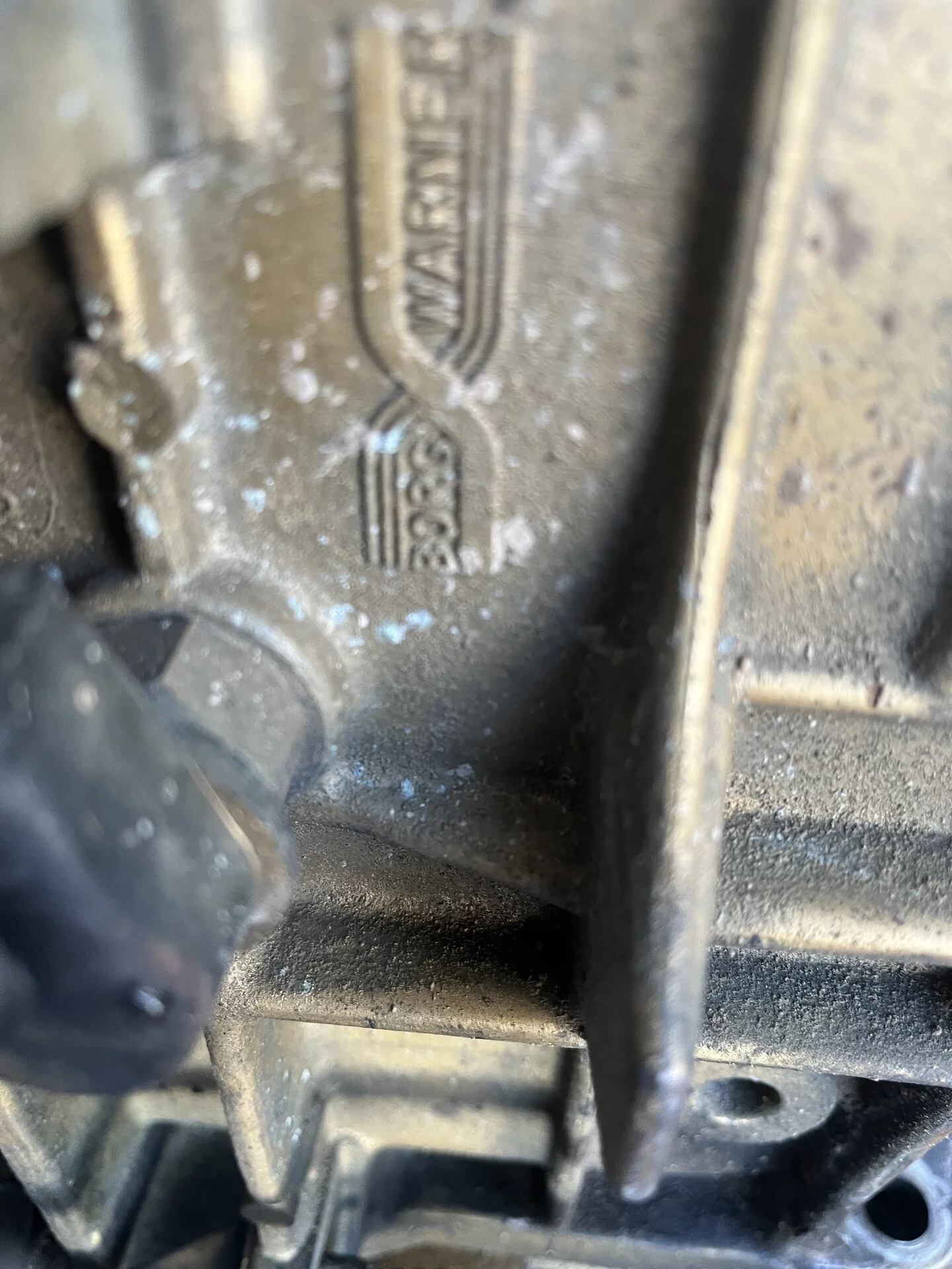

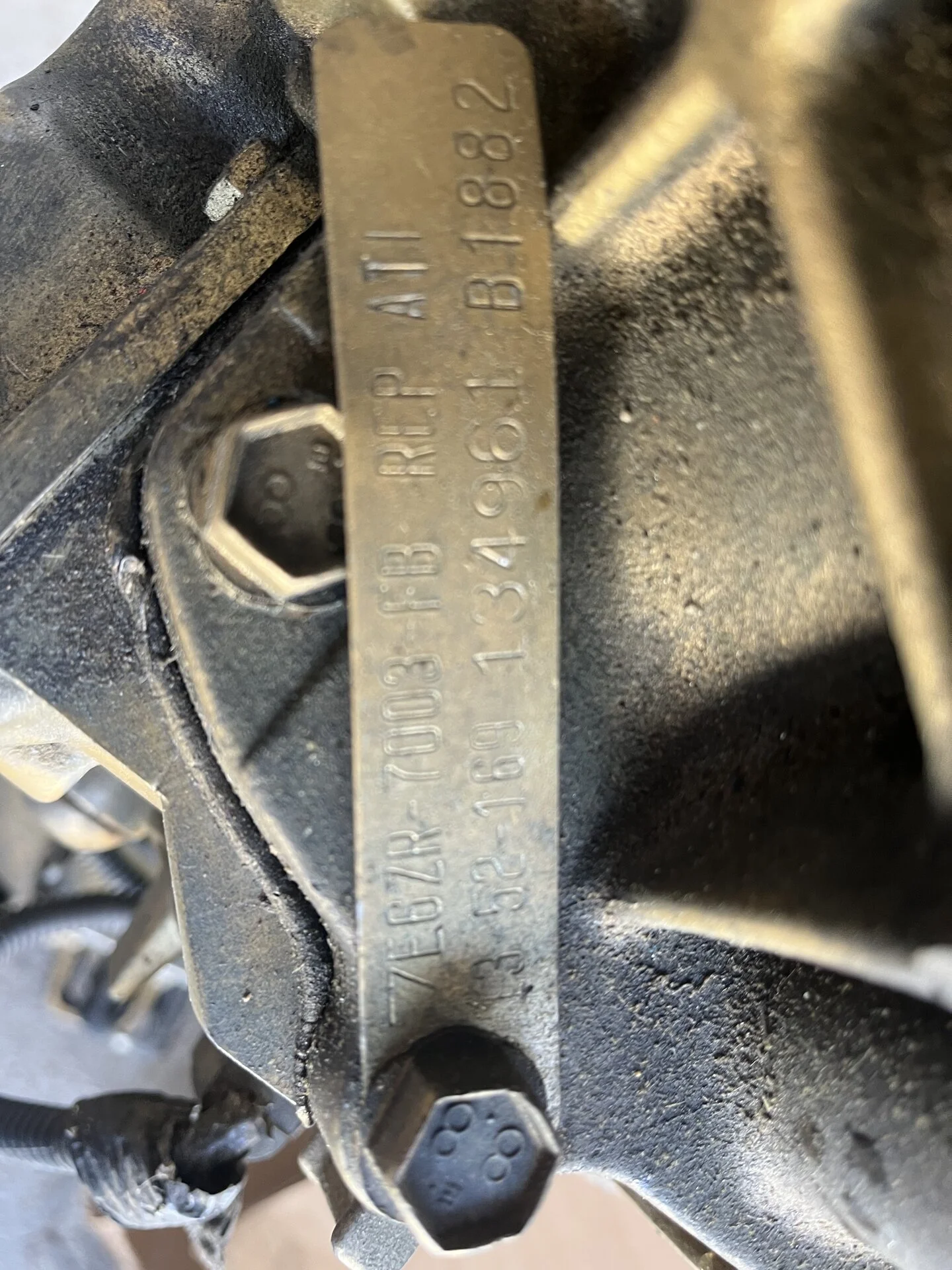

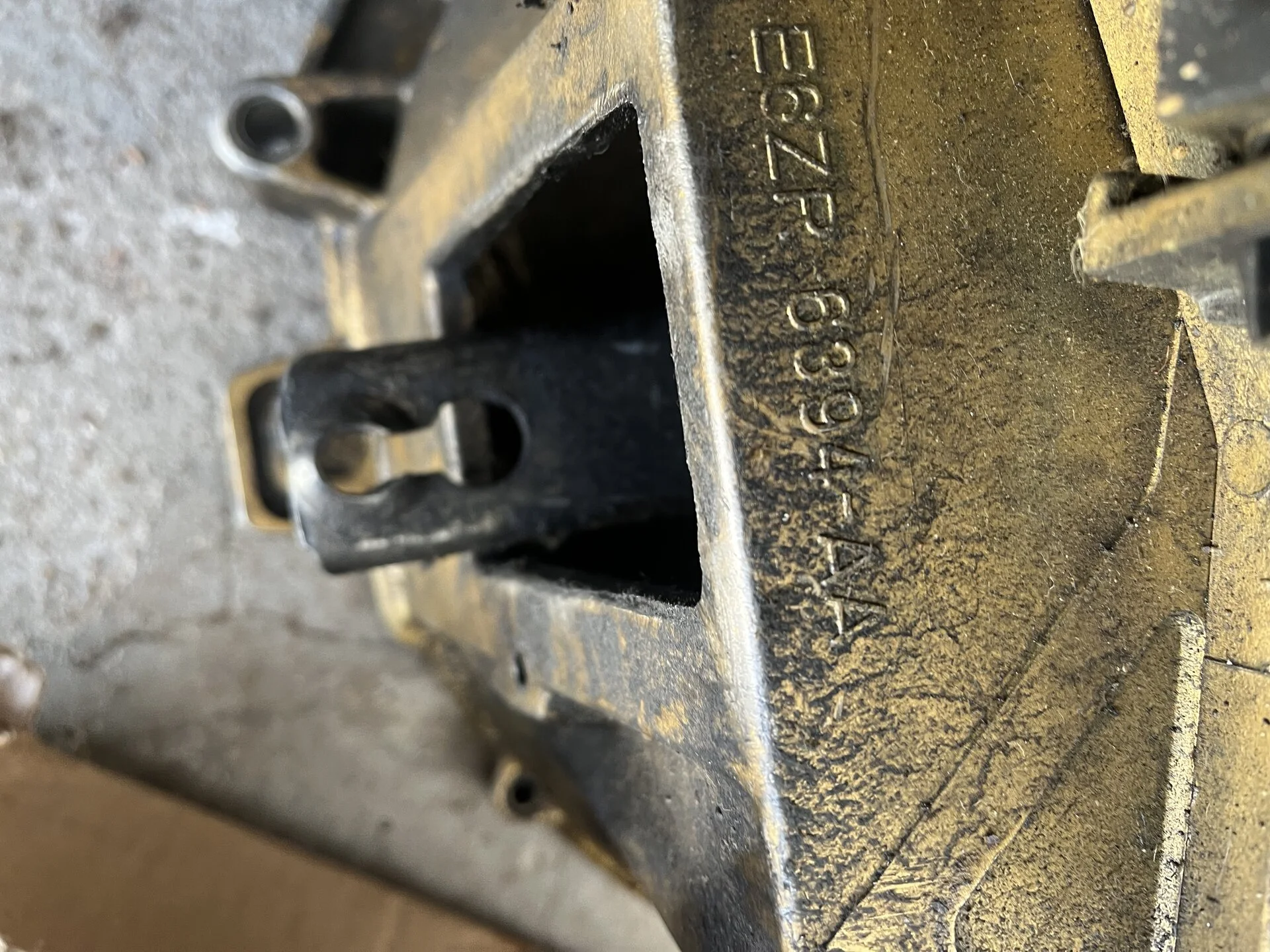

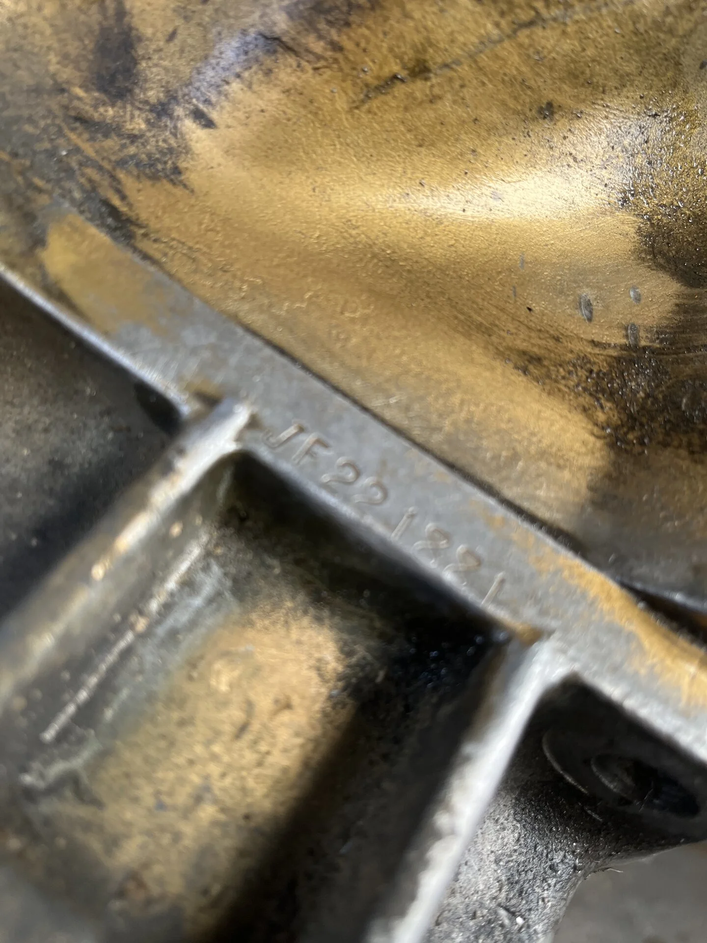

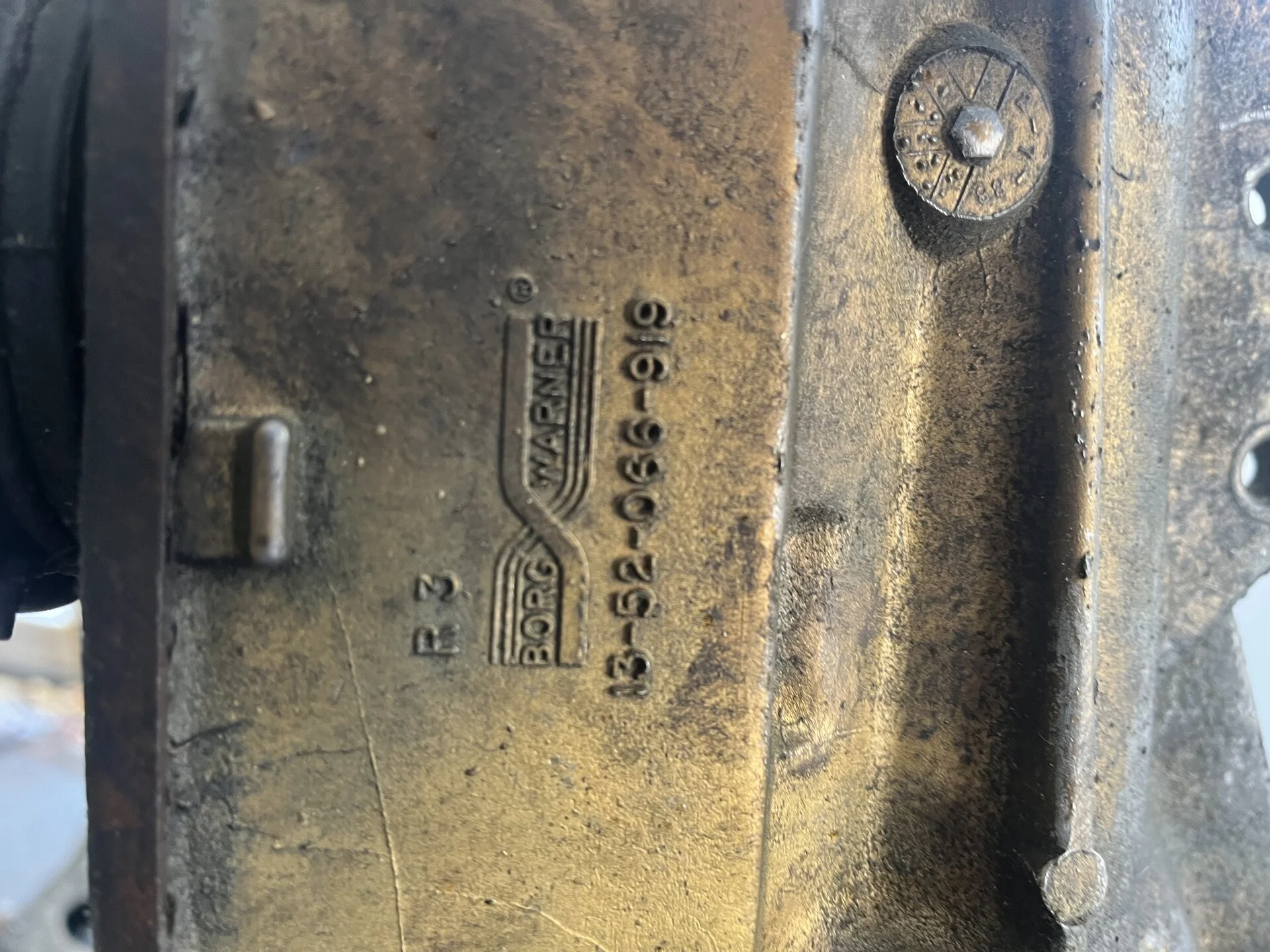

Anyone know how to decode this?

Yes. It’s an 86-89 World Class T5 and bellhousing.
The tag is the most important part. 1352-169 is 1986-89 T5
The part number JF221881 is a partial VIN of the vehicle the trans was in. J is 1988 model year
