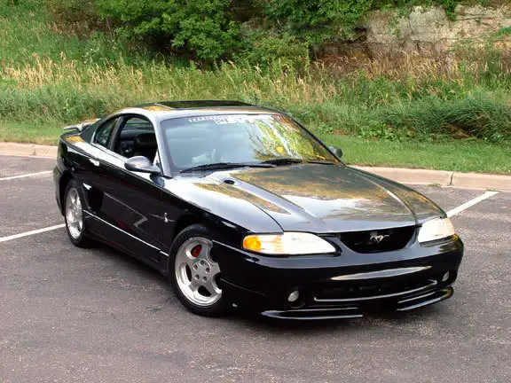

BTW, since I'm new. This is what the car looks like.

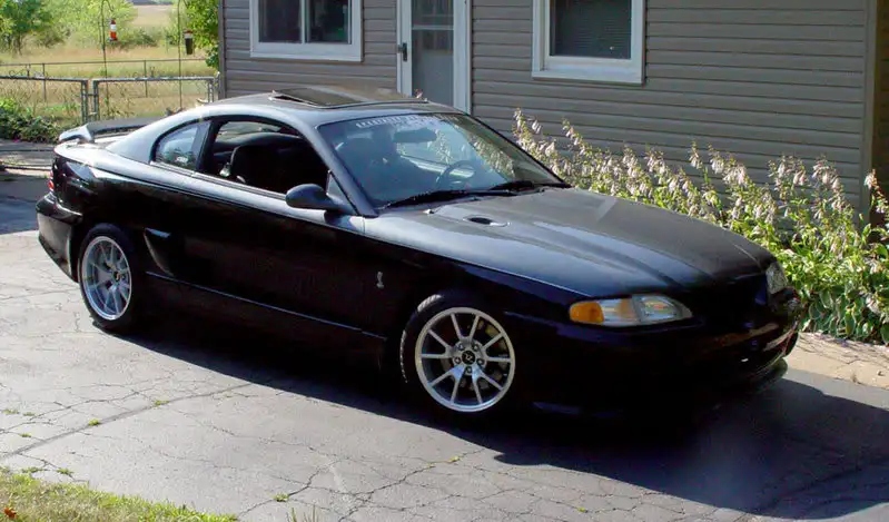

and this is with the new wheels (I know super rare FR500's)
