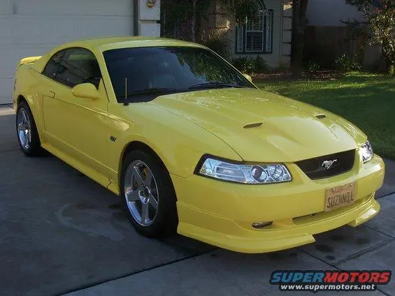

I've got that hood body shop installed it but did mention they had to raise/adjust the latch. Got any pics of yours? Here's mine.
