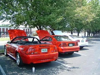

Mine's in the middle. I'll post better pics when they are installed. Nik_95Cobra....Your car is sweet. Trust me, when I was debating on getting those rims, your car definitely didn't keep me from buying them. :D
