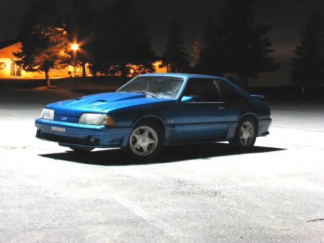

Here she is...

Car looks great. the water pump is a pretty straight forward repair but be careful with the bolts they are prone to snapping in the timing cover due to corrosion. when I did mine I soaked them down a few hours before hand with pb blaster and then I would back them out slow,then turn them back in then back them out and keep doing that and it worked. I then used a wire wheel to get all the white powder corrosion of the threads and shanks of the bolts and used a thin coat of never seize when I reinstalled them. These cars are kinda known for having to refill the oevrfill tank a few times before it levels off after doing a coolant drain. replace your stat while you are at it.
