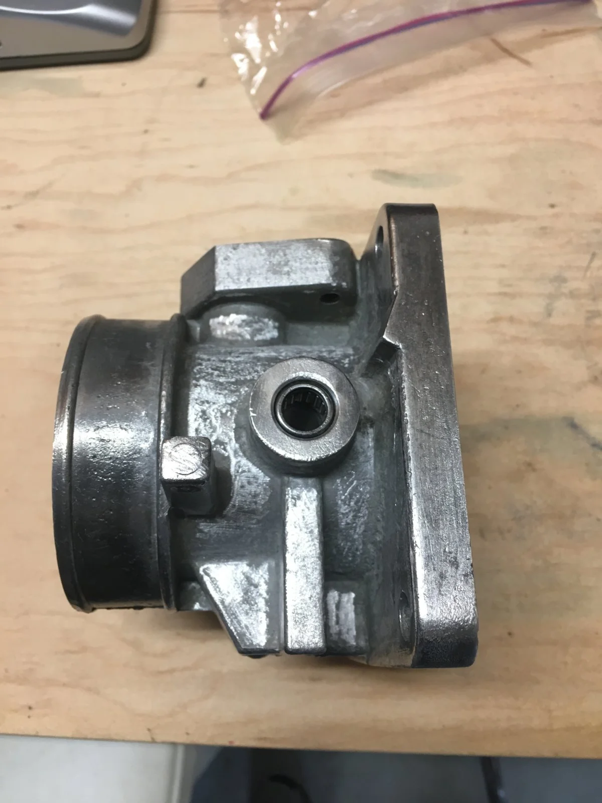

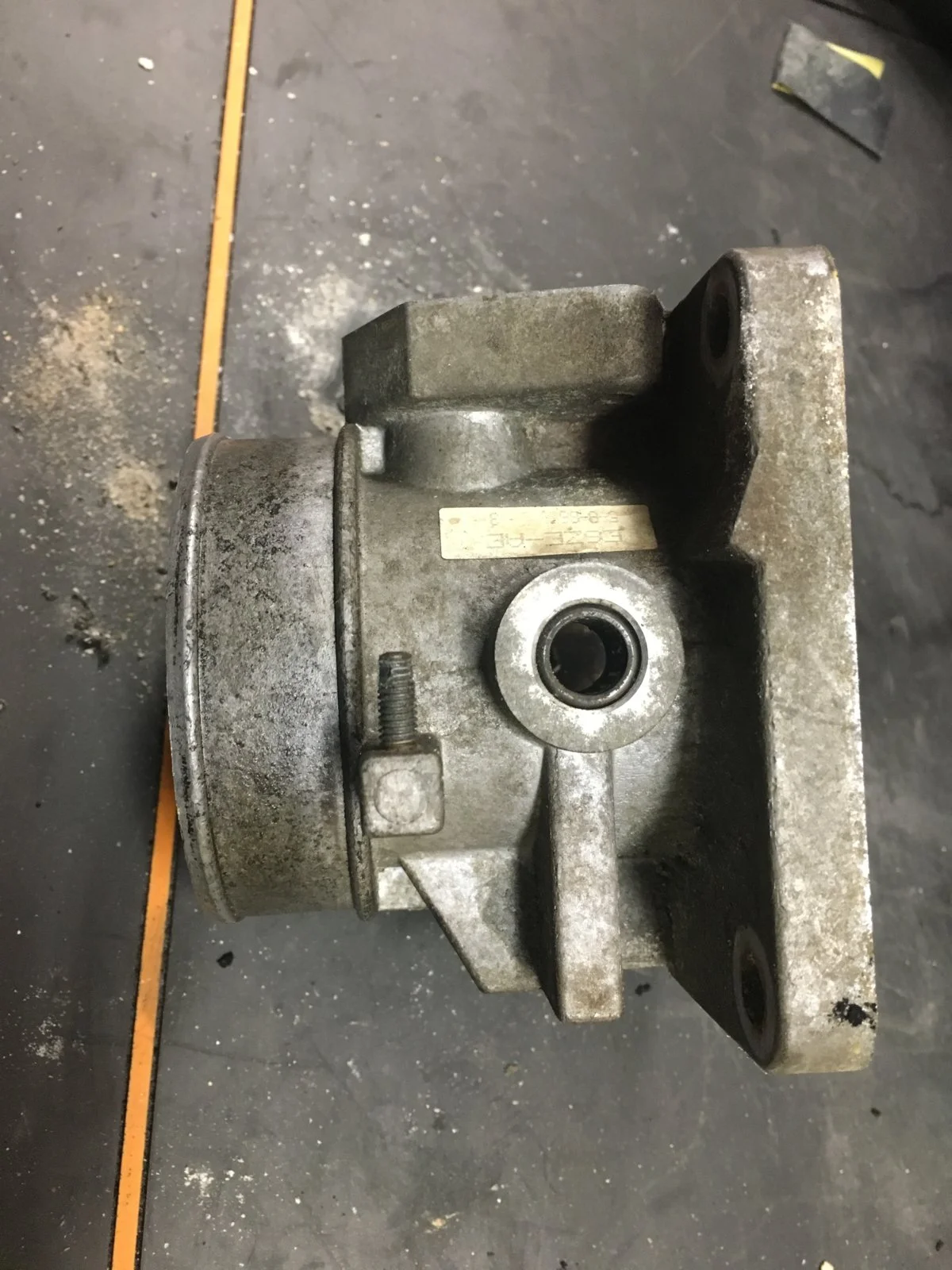

Here’s a before and after of my stock throttle body. A little time and yours should clean up fine!

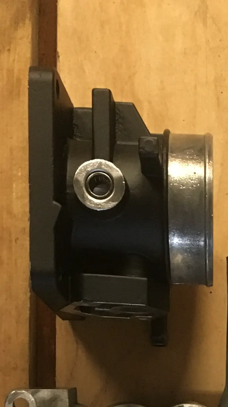

And then I went with some flat black to finish it up:
