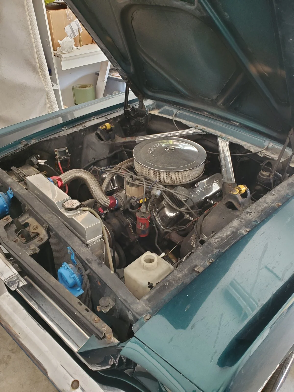

I just bought a 1966 Mustang from a guy I served in the Navy with and it has been sitting for 2 years. The previous owner before him replaced the original 289 with a 302. I already put a new battery and ignition switch in and finally got it running but there were a few problems. The car only started in Neutral and not in park. The ignition started on "On" and not on "Start" and once it started the starter was stuck on. I am a very novice mechanic but have plenty of time on my hands after work to work on this beautiful car but I dont have much experience. I'm hoping I could get a few pointers of where to start on these problems through these forums.

Thank you for your help and I've posted pictures as requested
Ok, I have installed a new bezel ring and starter solinoid thank you wicked93gs. The bezel ring did help. But the starter solinoid didn't fix the sound which I do not think is the starter now. I also installed the safety ignition switch which fixed my starting in neutral problem thank you to General karthief. I live a few miles near Nation Parts Warehouse Ventura so I can get any part same day. Please let me know if anyone has any thoughts on the noise. It's coming from the left side of the engine near the starter. Alittle exhaust/smoke aswell. I appreciate everyone's help so far.

And the started is on the passenger side right? The noise is coming from the area where the starter is it could be the wrong starter or flywheel, could you possible post a video with sound?

It is the ignition switch bezel ring. I tried uploading the video I took tonight but the forum would not allow me to upload it. The audio isn't the best but I could try to email it to you. It's a MP4 file
