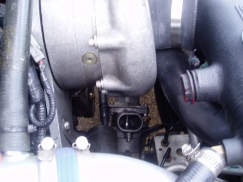

If you vent to atmosphere they will. Here's my old mondo vented to atmosphere. So loud it was obnoxious.

jeffrey81 said:
im so lost on this... i thought you couldnt release it into the atmosphere??? because of the maf???
You can vent to atmosphere with a maf as long as it is a blow thru setup and you put the bov before the maf. Any setup that has the maf before the supercharger, you have to vent back into the intake tube. procharger uses, or atleast used to use a setup where the maf is after the supercharger and the compressed air was blowing through the maf and you could put a bov before it but after the supercharger cuz the air wasn't metered yet.
