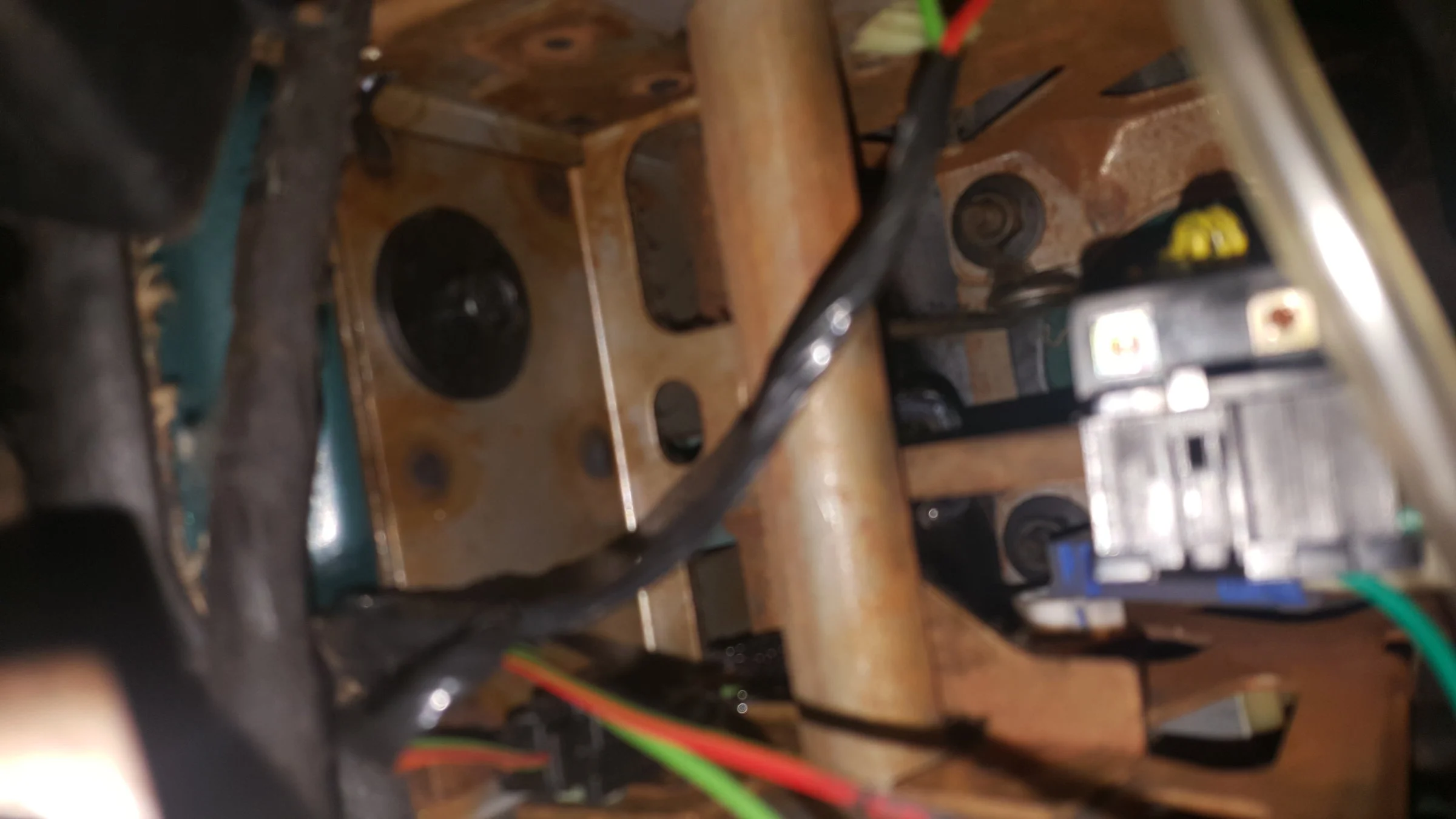

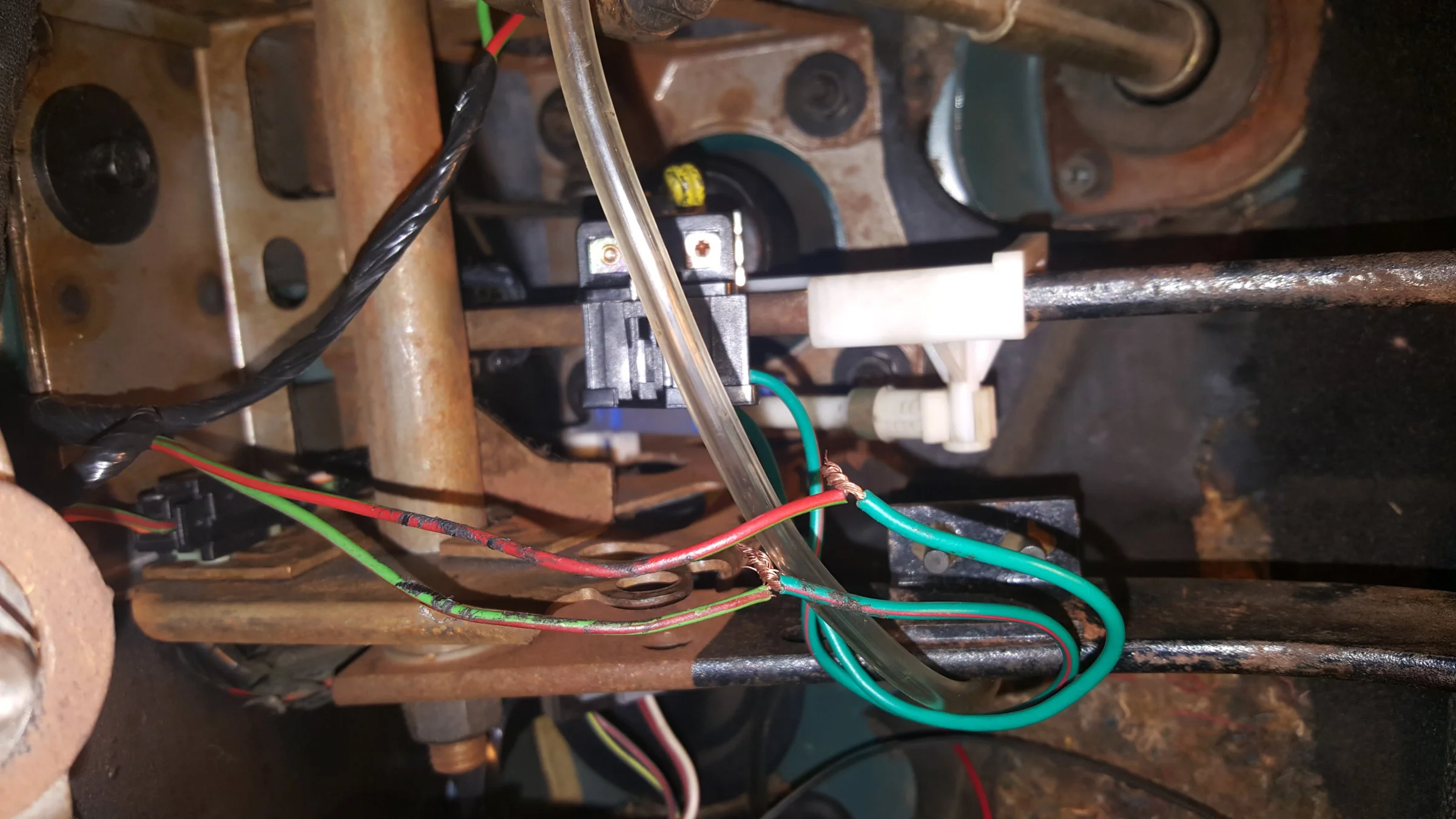

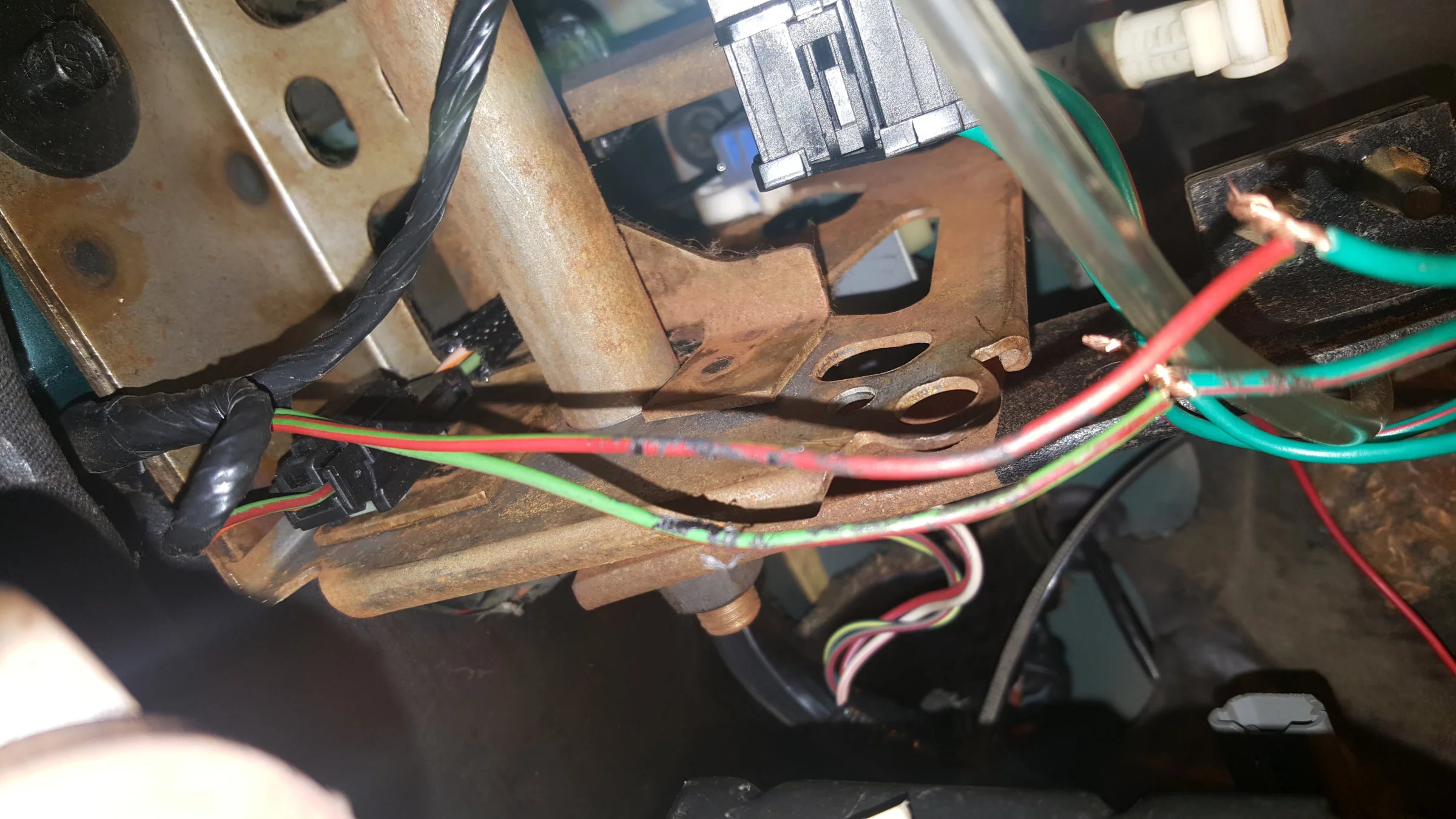

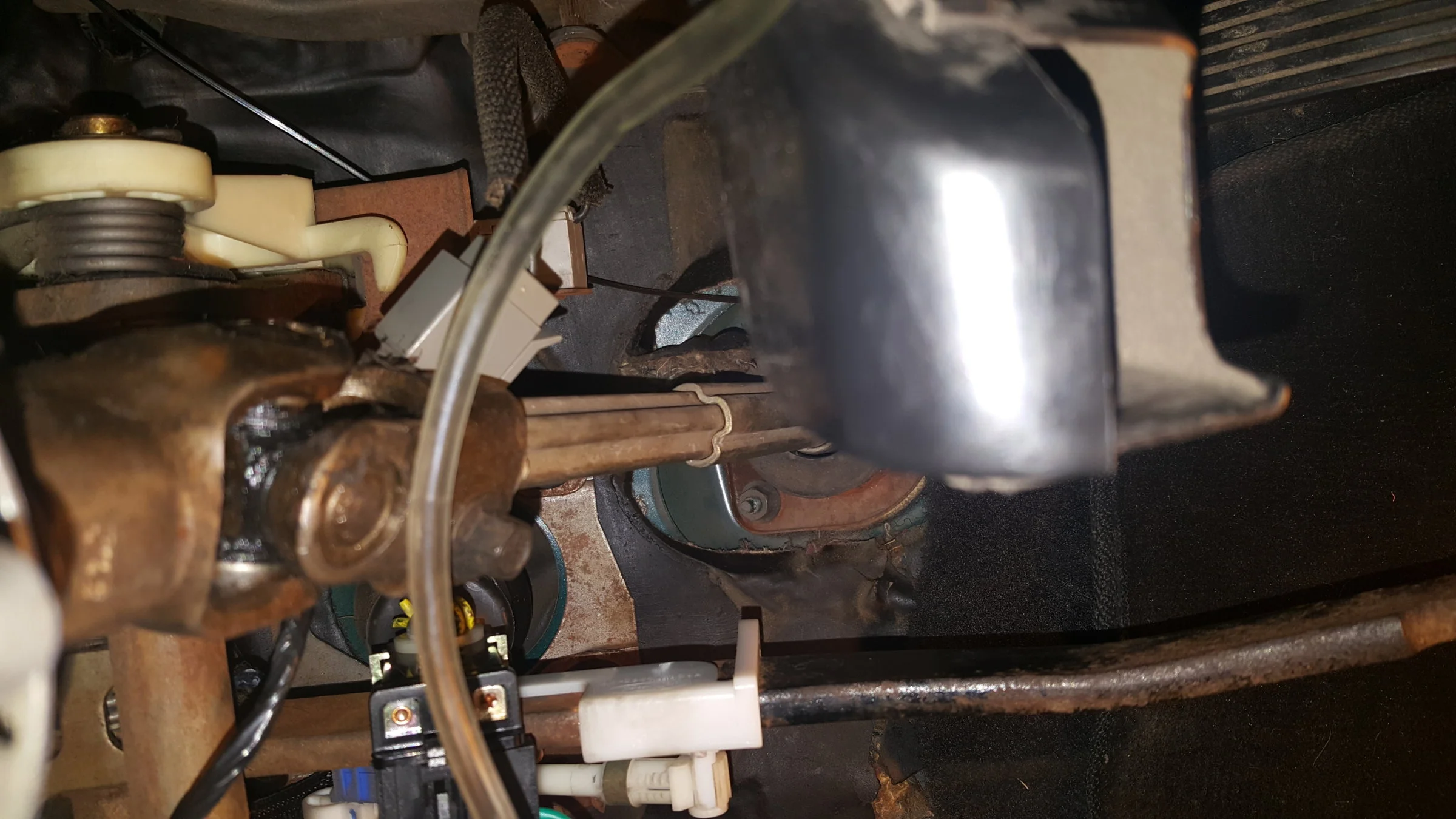

Here is 4 shots that should help.

First you need to soldier those wires together and put heat shrink on them, remove the boo switch and plug in the wires, according to the wire diagram the wire runs to the mfs (turn signal switch) someplace between the boo and mfs it should split to the tbl (third brake light) follow that and make sure it power.
The reason you are removing the boo from the peddle is so power is on, you don't have to hold the peddle down.

From your set up the bare wires are not causing the problem. IN fact they should be a benefit as touching them together SHOULD cause the brake lights to come on. IF touching the bare wires together does not cause the 3rd high mount brake light to come on THEN there are other things wrong here.
You need to go back an perform the tests to prevent a wild goose chase. Must of the previous advice was given with the understand there is +12 volts present at one of the leads going to the BOO switch.

Since the high mount 3rd brake light does not go through the multi-function switch it's almost certain that replacing the multi-function switch would not solve the problem IF the high mount 3rd brake light is also affected.
What were the results of touching the two bare wires together? Does the 3rd high mount brake light come on or not?
After sotering the connections and before taping them up I touched them and no lights came on. There is power to one wire. I did do dc volts and touched a ground etc to check for power. Went over all fuses again. All bulbs in tail lights work.
