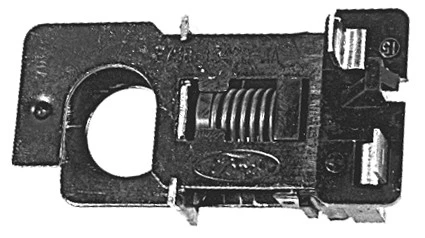

Here is a picture of the stoplight switch i replaced twice. There is also a white plastic part that connects to my brake pedal that moves in when i push the brake. can any one tell me what it is I cant find it in part catalogs.

'03 fuses (I know your's 2000) but they may be similar. By the way which fuse did you replace?
Interior
33 - Stop lamp switch, Speed control deactivation switch.
41 - brake lamp
