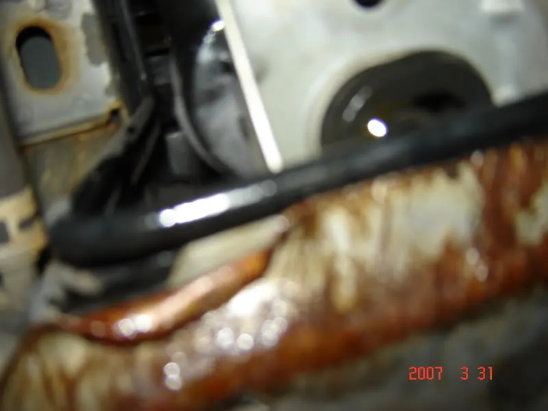

:bang: dumb ass move , had a flat the jack i had would only fit under front of car.
bent a brake line or lines on the front driver side ,now leaking, any one replaced before? replacements part or web site?
cant see much but...if you remove the hard line and figure out the length, you could buy some hardline at the parts store with the lines flared and the fittings installed. However they only come straight, so you will have to rent a brake line bender and try and duplicate the oem line. I have never done this so i dont really have any more pointers for you.:shrug:
