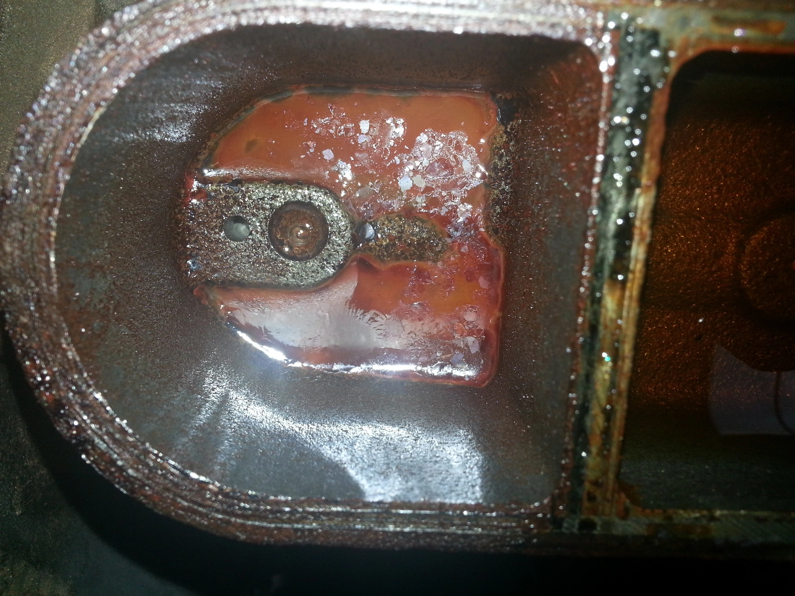

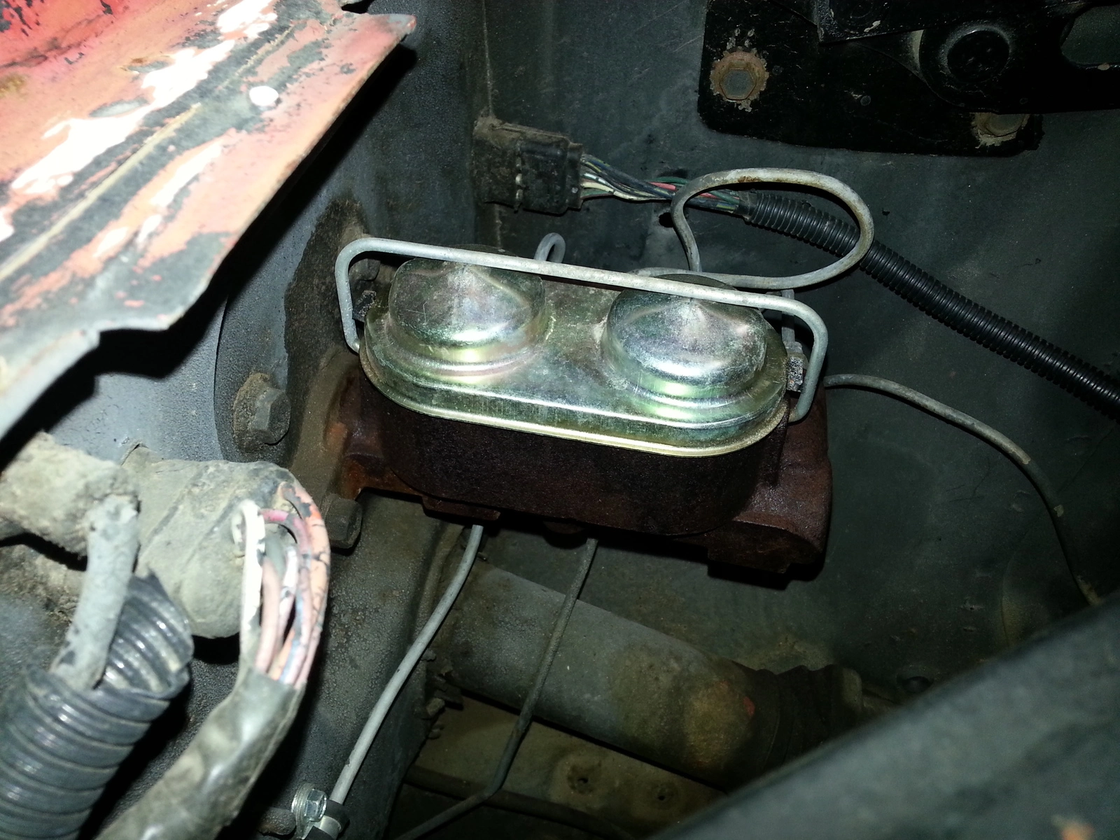

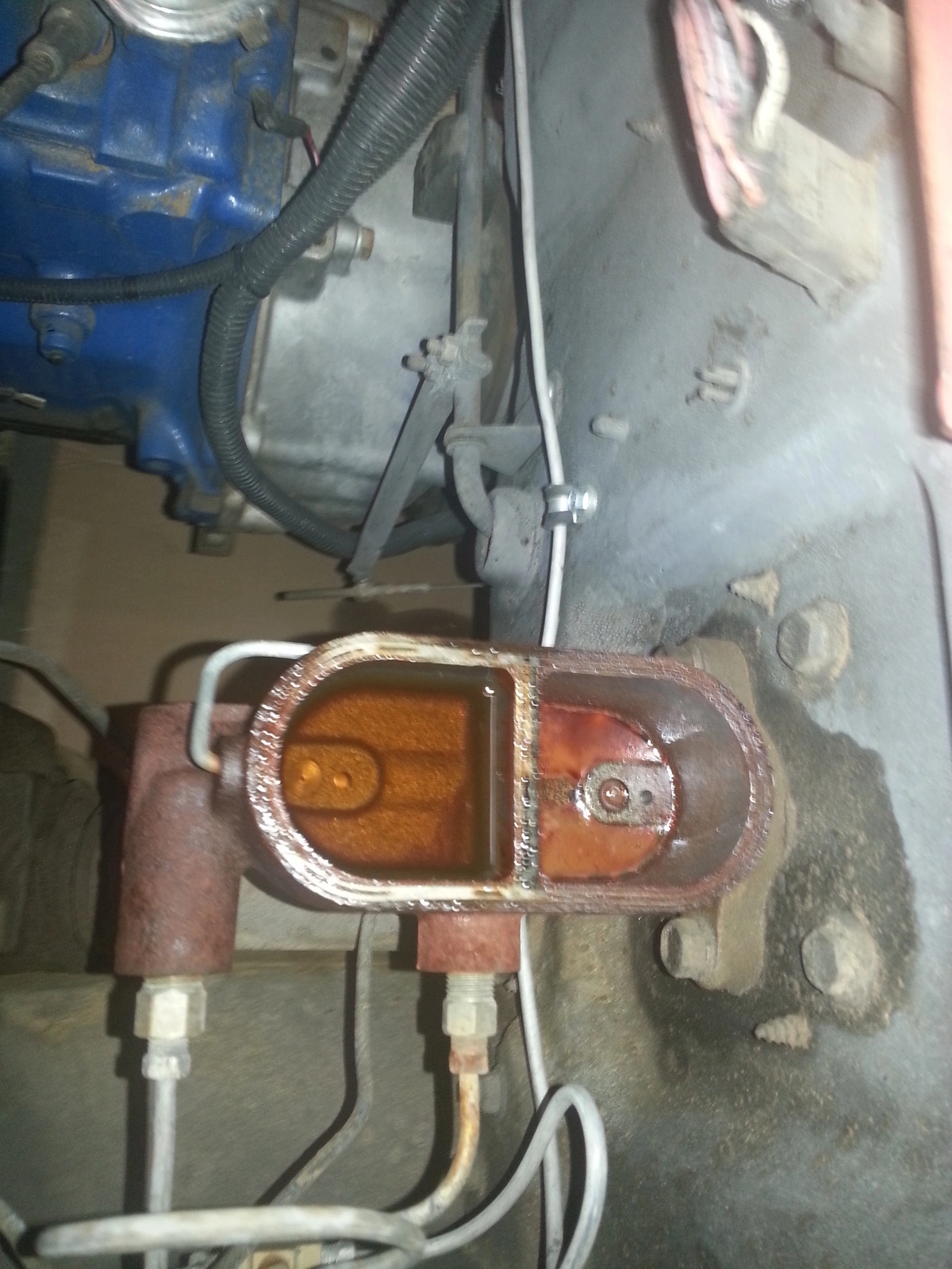

This is a car my son has always wanted, so we found it in someones backyard all taken apart. The previous owner put a new brake cylinder on it with dual reservoirs. Looking inside it looks like there might be rust inside the reservoirs. I do not know what I need to do about that issue, or if I should change to a different reservoir.

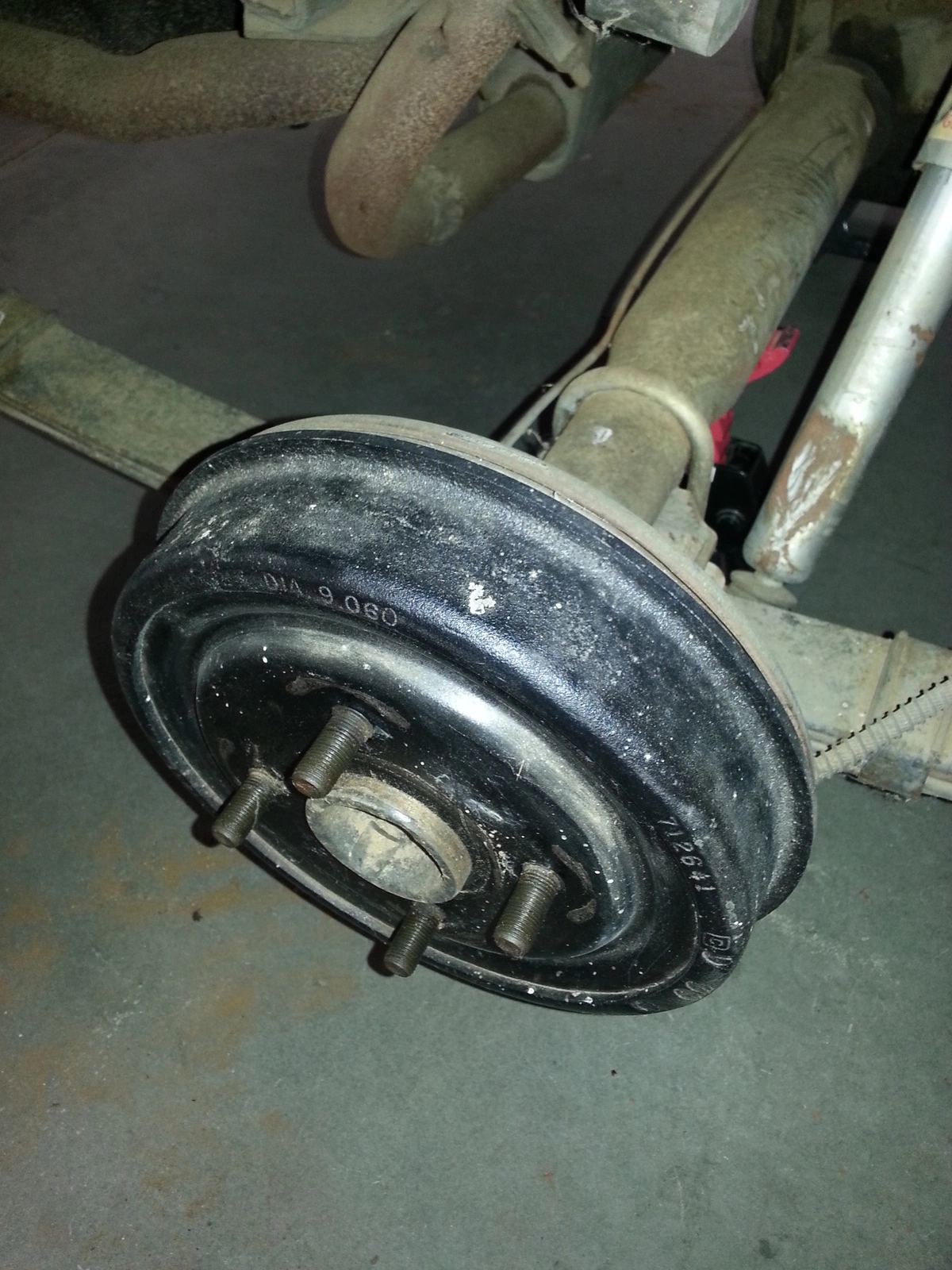

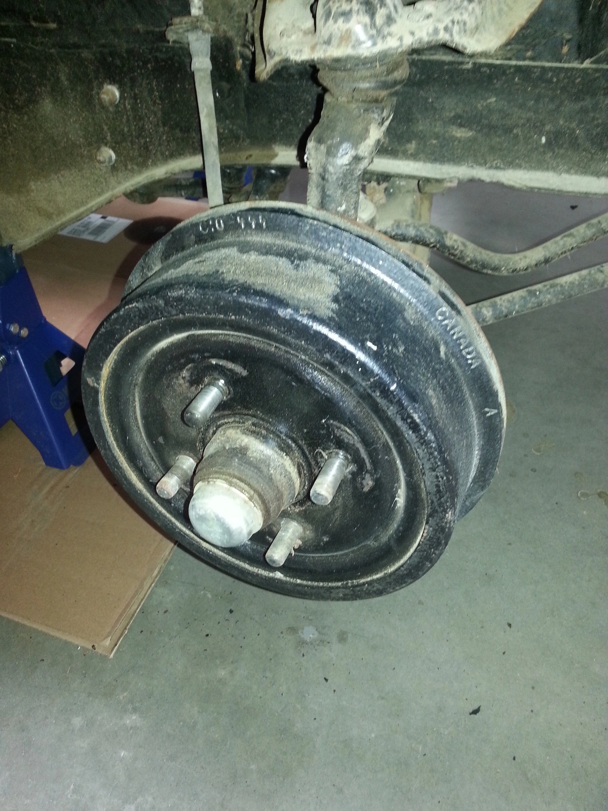

Upon taking off the wheels and tires I found that the drum brakes are different, front to back. The front drums and larger and are imprinted with "CIO 444" amd CANADA. The rear drums are imprinted with "DIA 9.060" and the number "712641" and the word "Century". I have a suspicion that the front drums are not the same drums that the car came with, but do not know how to understand what the full situation is.

Welcome to Stang Net . If you are going to stay with the 6 cylinder four lug will be fine .There is a company that makes a disk set up with 4 lug .
The Original master cylinder was a single bowl ,someone changed it over to the duel 67 up type and that is good . I think @rbohm knows the name of the company that has the 4 lug disk .
