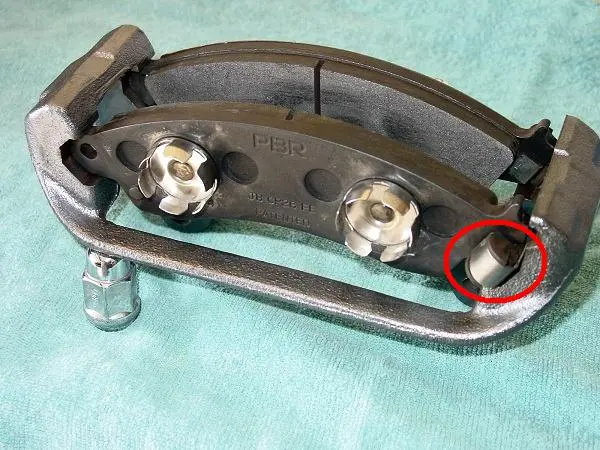

that's exactly what the problem was gearbanger. I looked at my old pads after I got home from work and I had forgotton (well, didn't know they were there lol) to take the anti-rattle clips off the old pads.
Just finished putting them back on the new pads and all is well again. Car drives like a dream and stops without the scream :D
It's amazing how much difference those little things make!!!!
-J
Refresh my memory. Where are the anti rattle clips on the Cobra/Bullit/Mach brakes? The top of the pad is a half hexagon to fit the bracket. I don't recall a rattle clip.
This is the part that I was talking about...little thing made a HUGE differnce. Car isn't making a peep anymore :bang:
If you still have your stock (or old) pads, check them...it just clips on and you should be able to easily pull them off and put it on the new pads.
