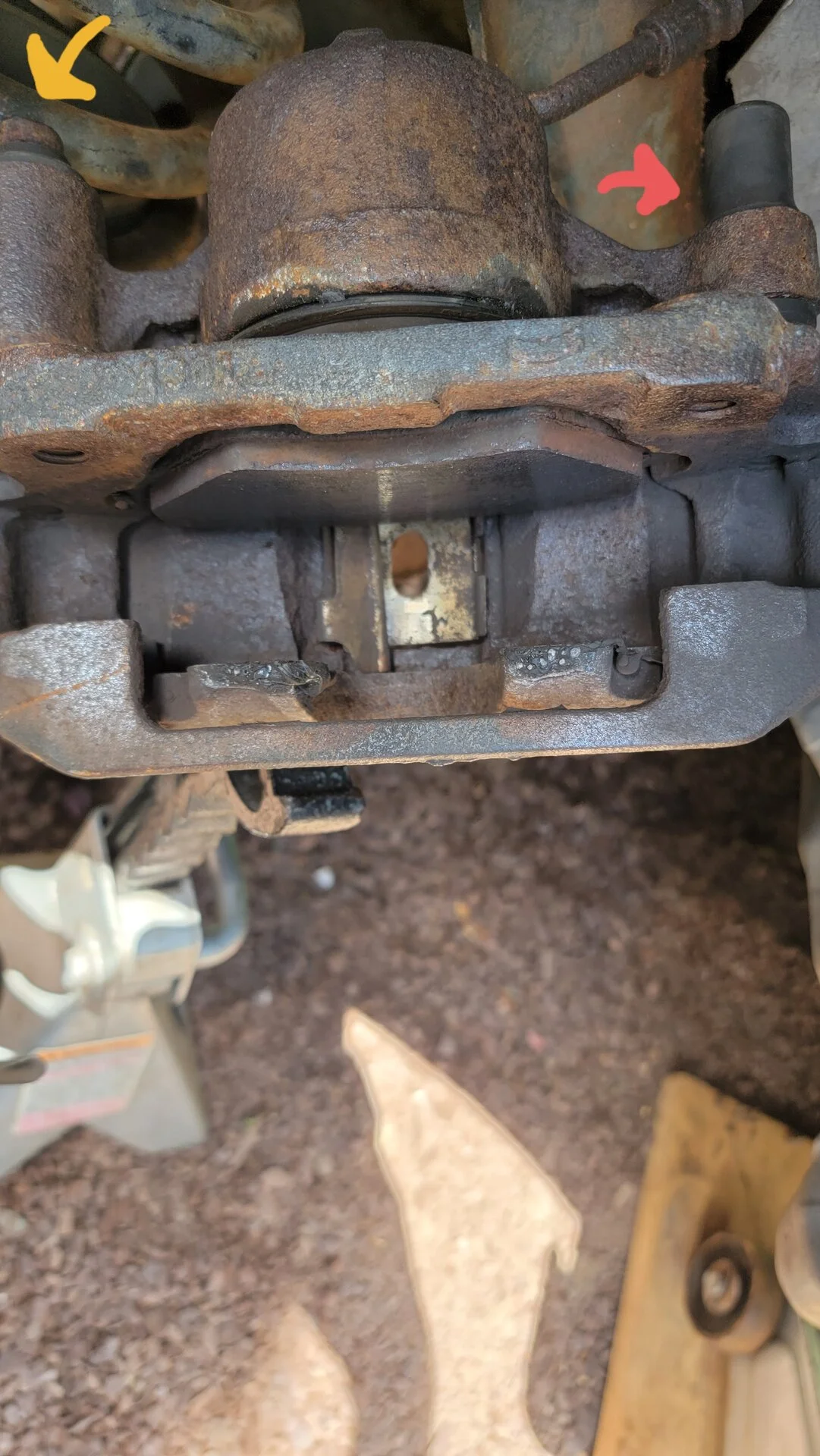

Pic attached. Yellow arrow is where there is a bolt with a torx head and I can see it without removing anything. Red arrowside appears to be just a cover. I didn't want to try and take that cover off and break it.

Looking at the rust on the caliper it look like the original. Did you feel any resistance when you pushed the piston back in? If so, it could be starting to seize up.
The most common failure I see is people not cleaning out the pins and re lubricating them. Sounds like you figured it out.
Just FYI, those brake bads are designed to be installed with the caliper bracket still on the car. It looks like you took the whole assembly off. You hold the rotor tight to the hub with a lug nut. Install the caliper bracket onto the car, put the pads in the caliper bracket, and then put the caliper over the pads. Makes it way easier.

i replaced rotors, so had to take the calipers off.
and yeah, i dont install the pads with the assembly all in one piece, i have it apart. i took that pic before i started taking it apart cause i wanted to make sure i put the new clip back in correctly.
If it took two c clamps to get the pistons to go back then you need s new caliper. It shouldn't be that hard.
