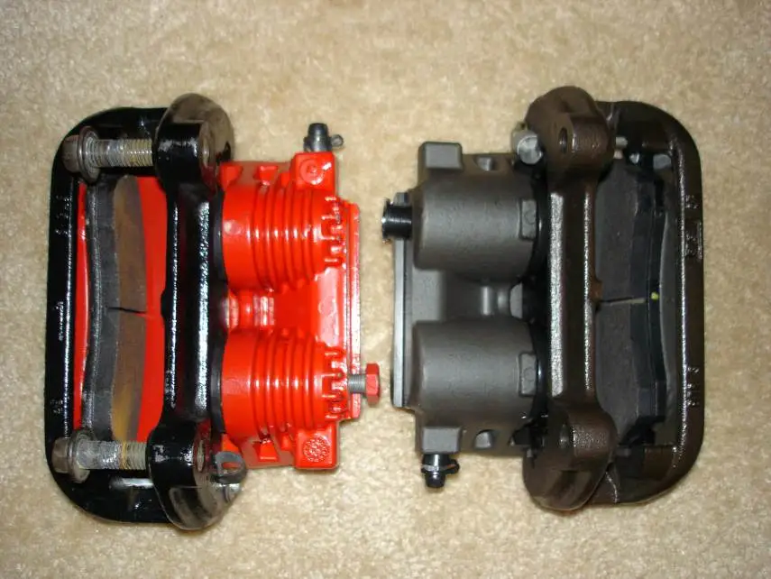

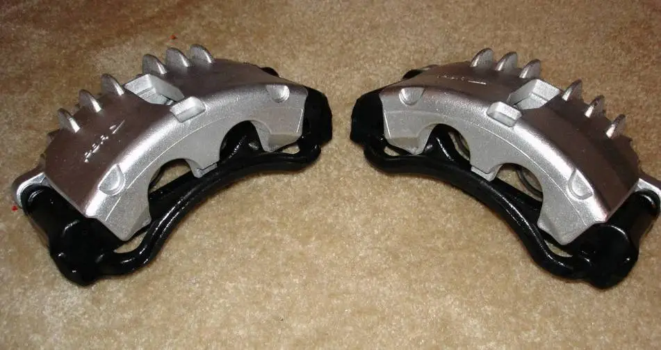

They actually are.
PBR is a brake company that manufacturers calipers. They make them for dozens of vehicles, but for the Mustang they make THREE calipers
94-98 Cobra
99-04 Cobra/bullitt/mach1
99-04 GT/V6
The cobra calipers are interchangable, just different castings due to the larger pistons 99+
99-04 gt.v6 (you can see the PBR logo on the left caliper)
attachment.php
BTW none of these will bolt to a fox spindle without some SERIOUS modification
