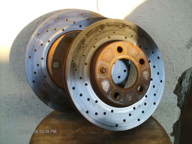

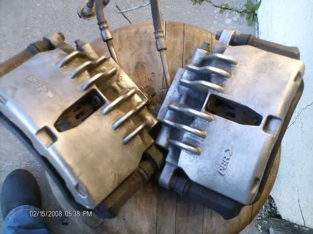

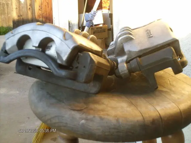

PBR calipers.99-04 V6/GT
cheap-o cross-drilled rotors.10+inches
