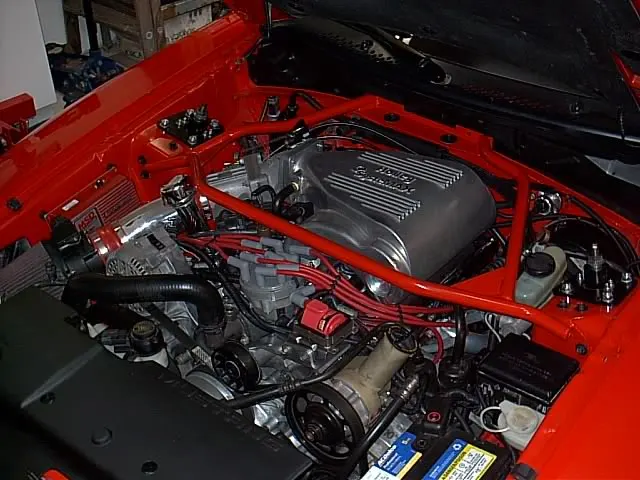

Where do yo have the msd mounted it may be too close the abs port and cause the light it does in my car all the time
Really?
Look at the pic below. Its on the passenger side by the air filter.
