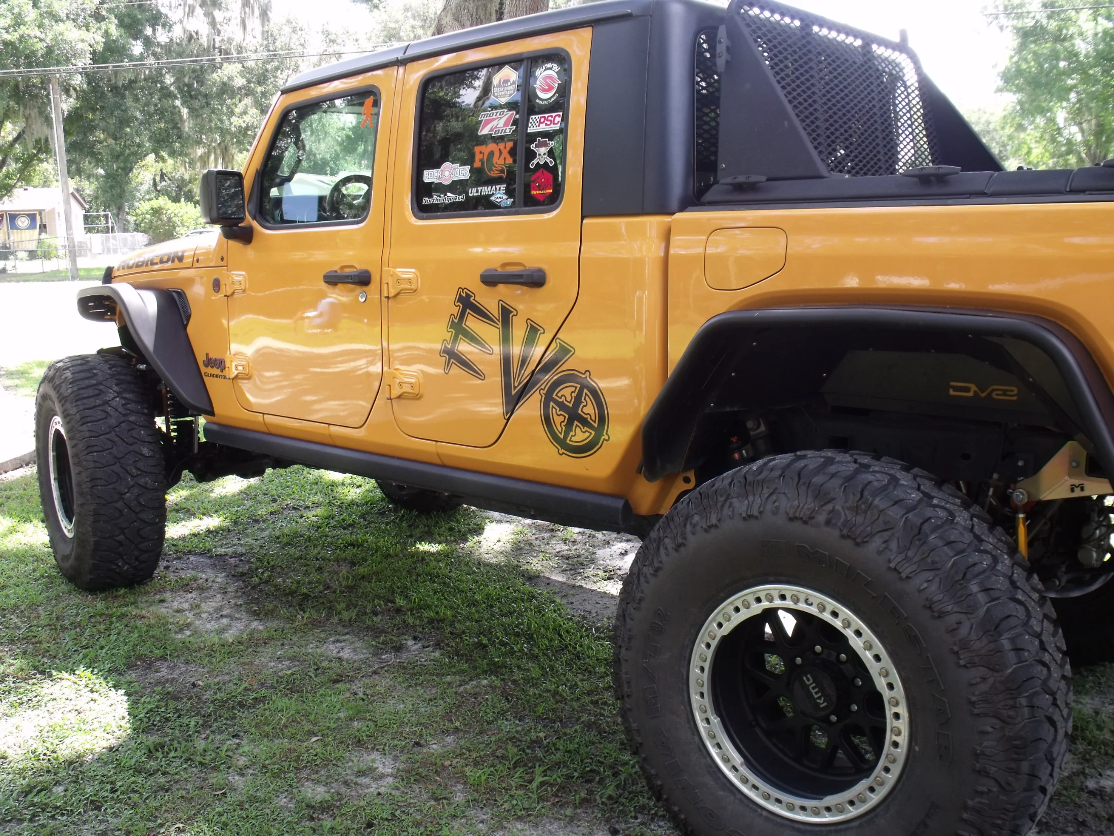

If you have no help, my neighbor " with the 6 million
dollar jeep" swears by the " one way" bleeder screws ........ \
