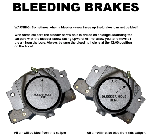

Did you install the calipers on the correct sides? If the bleeder isn't in the right spot, you'll never get all the air out.
Sometimes pointing up isn't correct. All depends on where the bleeder draws from.
