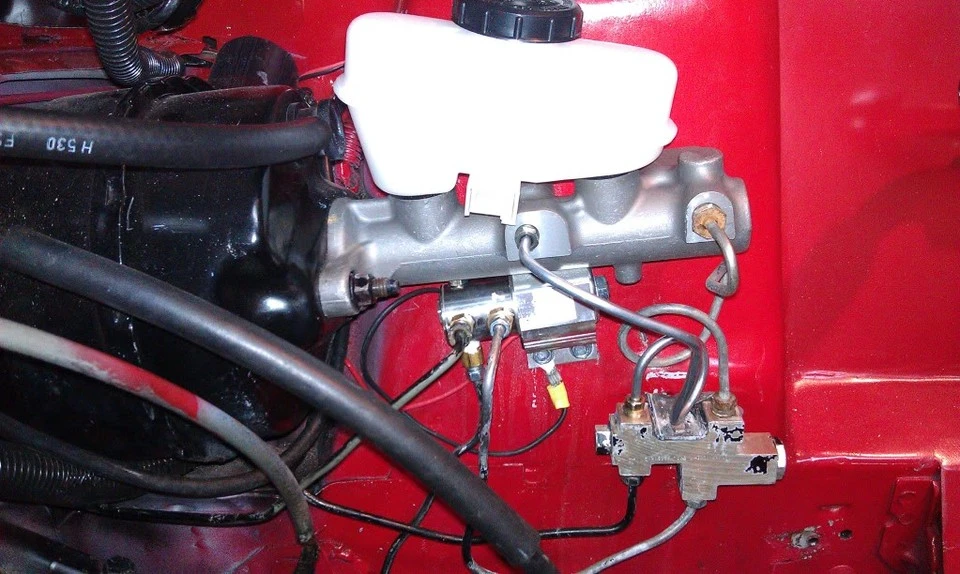

I installed my 93 cobra master cylinder and the line locks today,fill the resevouir and pedal just keeps pumping no pressure and no leaks either.Any ideas here is a pic of how it's hooked up. peace
john:p
It will all get painted again as well.The way it's routed is well you see the M/C goes into the top of the proportioning valve.then the front bottom of the prop valve goes to the "in" on the line locks.then the 2 "out ports" go to each front brake.peace
john:p
Jack the rear of the car up and try to get the MC level. You might be able to get it to bleed out that way. Worth a shot.
Otherwise, gotta take it out and bench bleed it
yes you need to bench bleed before going any further. that will solve a lot of problems and questions later on. I ran into a lot of issues when I swapped to 5 lug and starting from the top down fixed all the issues. If you dont it just compounds at each component. good luck.
